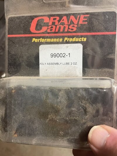

And will use the Comp Cams moly lube to coat the cam lobes when I go to install the cam later today
