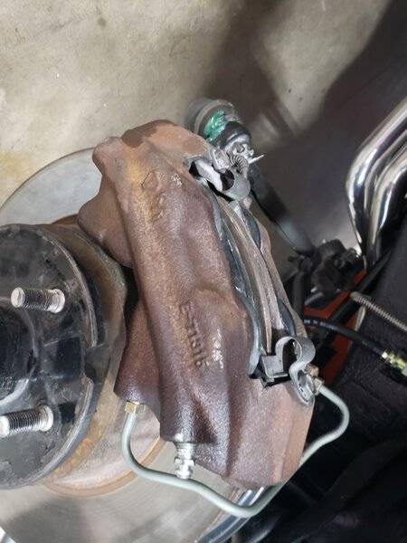

let's see a pic of the brakes & rotor... that *should* tell us right quick.
(i suspect i know what they are, but don't want to assume)

Looks like the dude has a KH setup (you can see the hard line on the caliper in the first pic), suggesting that he needs little ball joint 67-72 arms.

OP has Kelsey-Hayes SBP discs, so standard small ball joint UCAs.

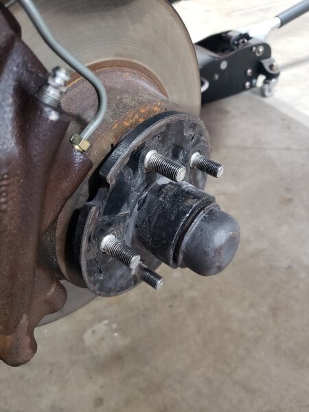

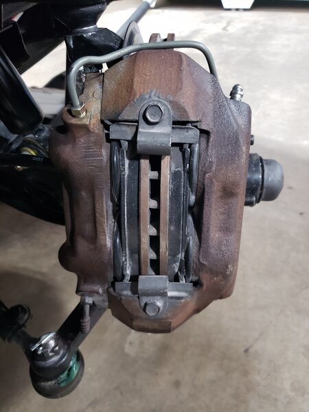

Really appreciate all the help> Here is some more info:
1) Its a small bolt pattern, but it appears to be an adapter plate has been added to achieve this.
2) The ball joint is is measuring just barely over 1-3/4" with a tape. square to square. It has K704 Stamped into the steel/ master pro. appears brand new. Im thinking thats the 1.809" ? ( however remember the origin of the post, the ball joint "pushed through" the a arm/stripped the threads, perhaps the previous owner installed the "small" ball joint into the "larger" A-arm? or perhaps the threads are the same and its the ball joint shaft that's different?) Here are some more photos.

That's not an adapter on the brakes- that's just the stock hub. The rotor attaches to the rear of the hub via a set of swedged wheel lugs.
All stock stuff, including the upper A arms.
If you don't believe me, compare it to the factory service manual and you'll see.
They're available for free at mymopar.com . Get the actual FSM, not a generic Chilton/Haynes/Motor/Whatever manual. It has every bit of information you'll ever need for your car.
This confirms you need little ball joints and 67-72 arms.
