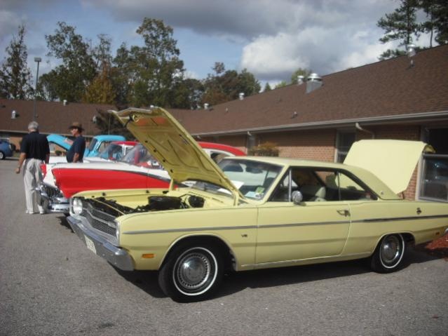

This is what it looked like when i took it to its first show which is a show i put together so i had to trailer it there, the only change i made was the wire wheel hubcaps b/c the car came with plymouth wheel covers, the seats are not in it

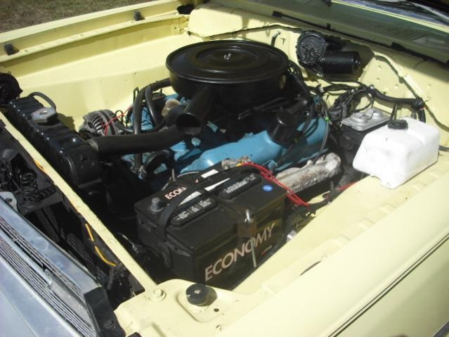

engine- all i have done is added an eletric fuel pump, rebuilt the carb, and replaced the timing chain altenator, battery, and painted, still have smooth running issues so intke manifold gasket is next got the gaskets today.

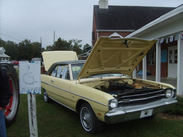

vinyl top-
have always hated the problems vinyl tops present , rust, puckers, bublles, shrinkage, but i think the car is to plain with out it, solution
i redid the top using textured bedliner spray, masked in three sections to simulate seams and mixed up a satin finished antique green to brush over, you cannot tell it is not vinyl.btw found 69 style hubcaps

i see the engine in the above pix of the green 69 is red while mine is blue, my car is #s matching except the engine was replaced several years ago which color is my engine suposed to be , i thought all post 69 318s were blue until 1985 when they became black

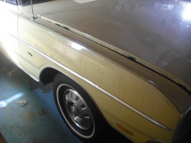

rt front fender molding needed
this is the molding i need - it was bent like a horse shoe when i got the car but i straightend it out - it still has a slight bents in it
