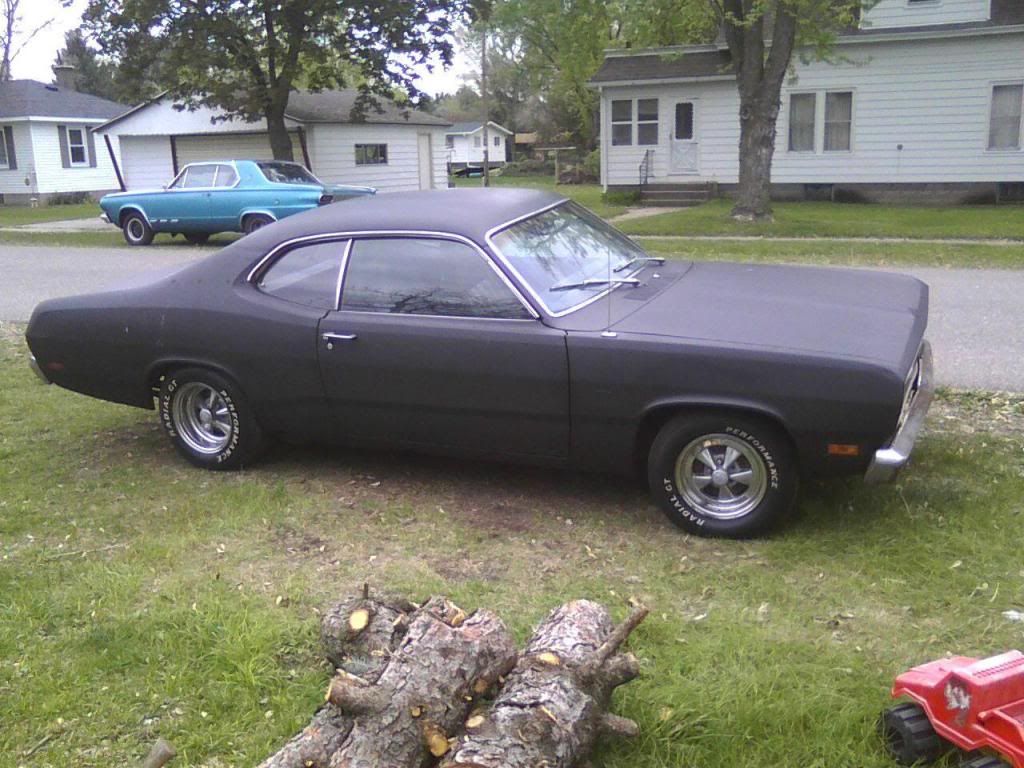

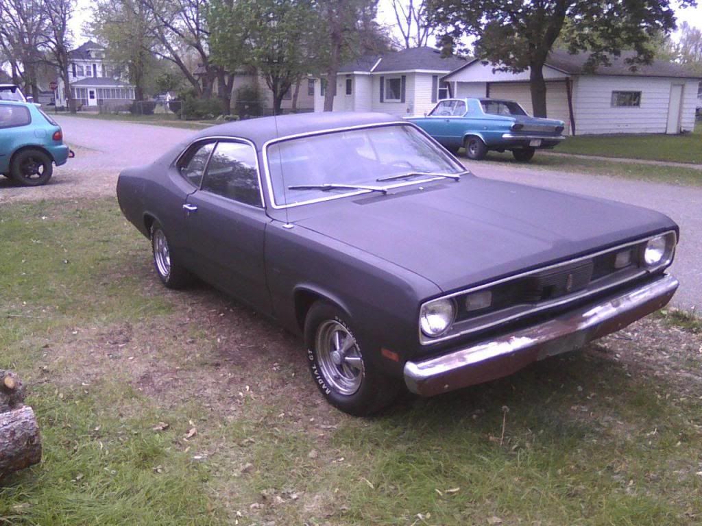

Pics of the car...

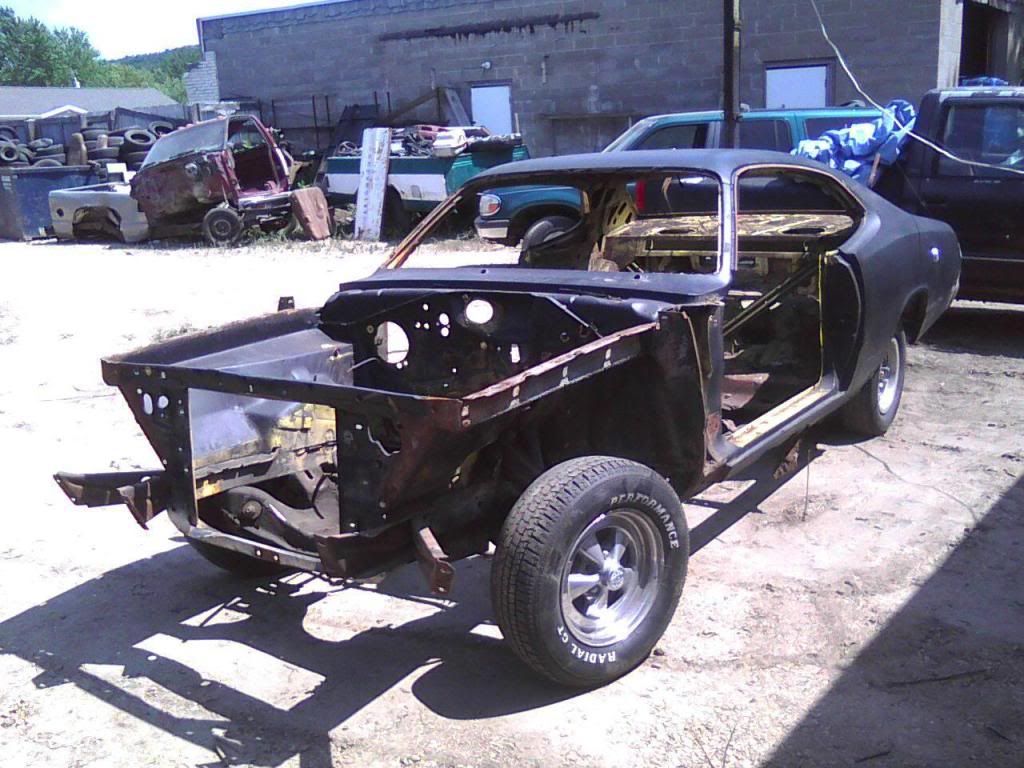

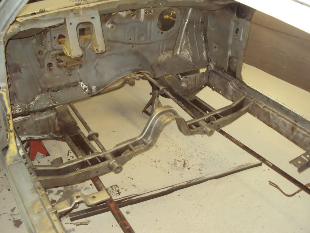

I then stripped the car down as far as I could and still be a roller...

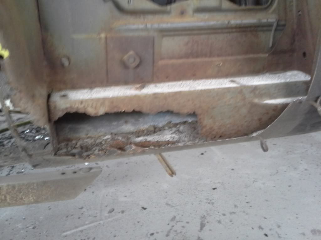

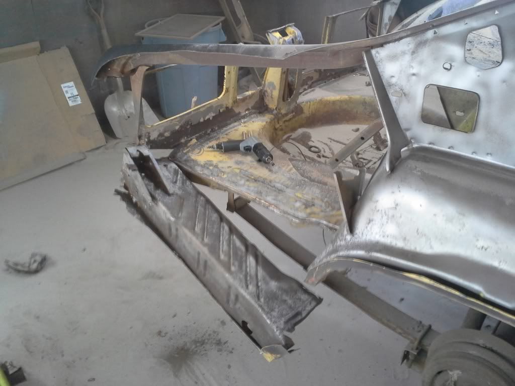

I found huge holes in the floor pan the rear quarters are both full of mud and the taillight pannel is shot but its pretty solid where it needs to be the most... Fire wall needs some repair on the passenge side... So i removed what was left of the old floor pannel and the left rear quarter. You can see where i repaired the fire wall....

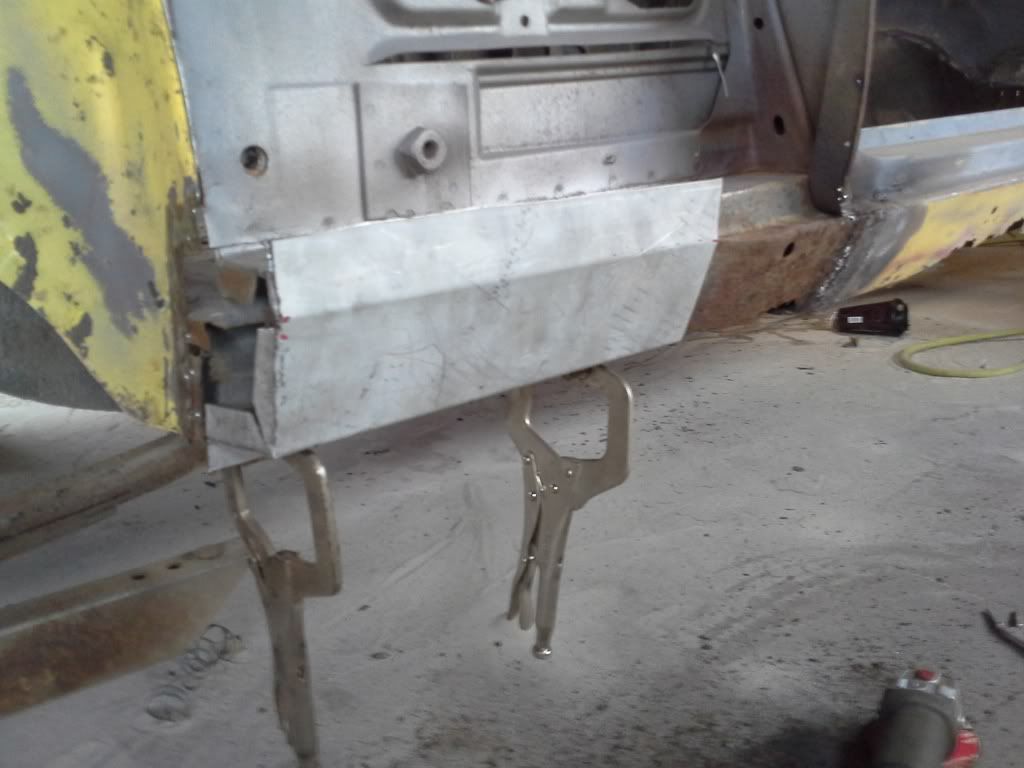

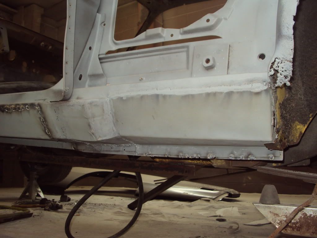

I ended up rebuilding alot of the lower rocker behind the quarter...

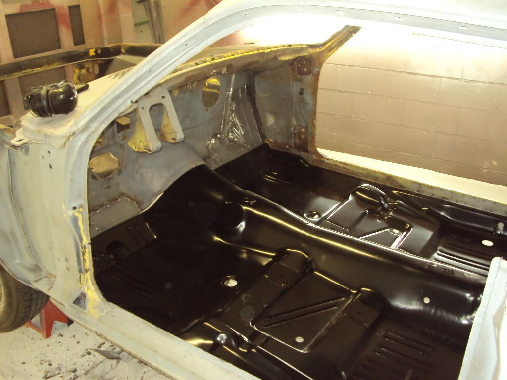

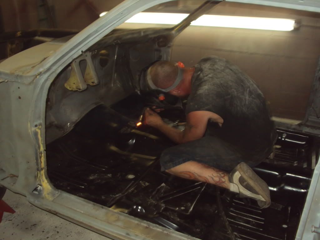

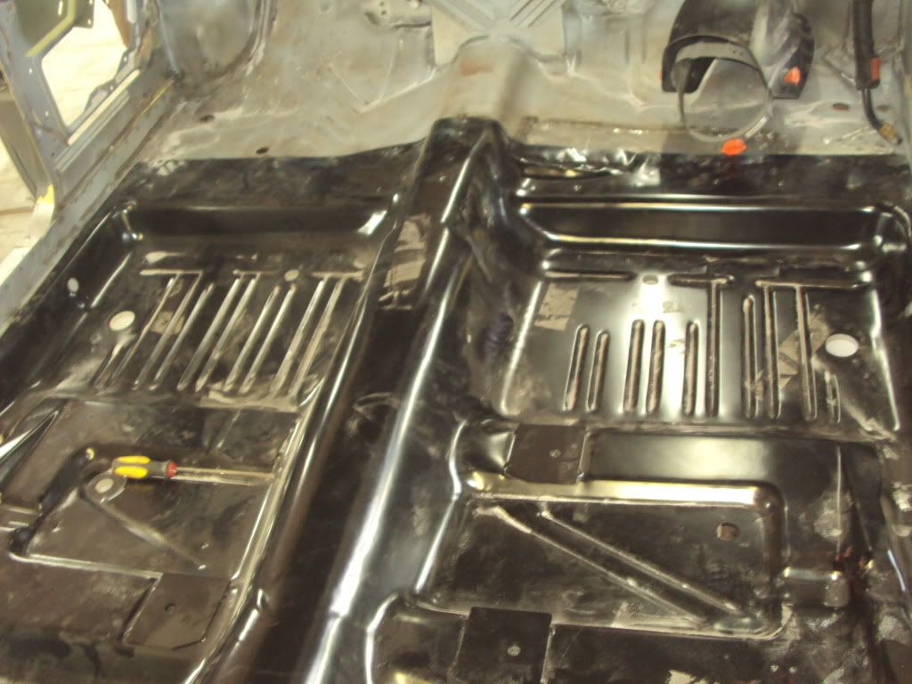

I then fitted the floor pan and finaly welded it in to day....
And this is me welding away.....

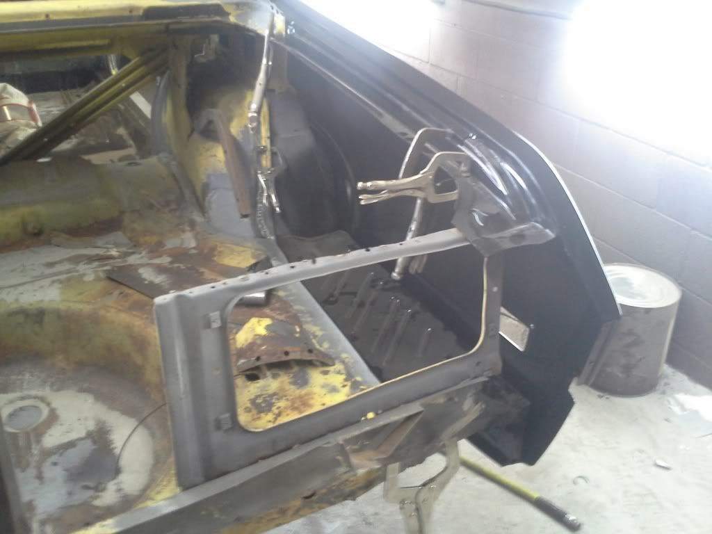

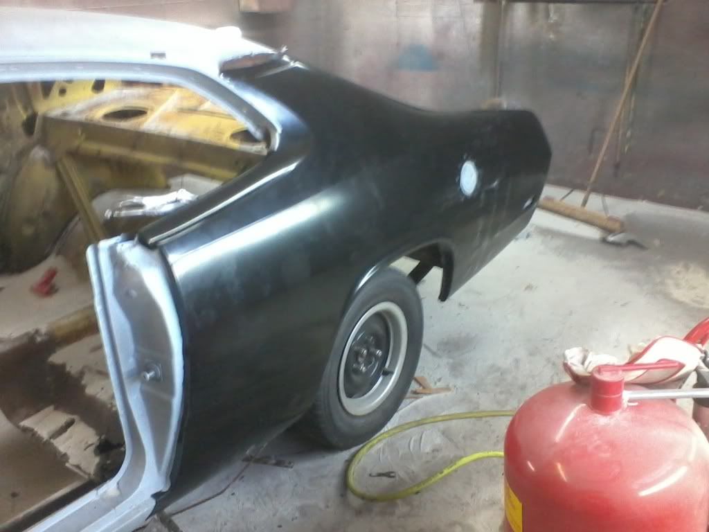

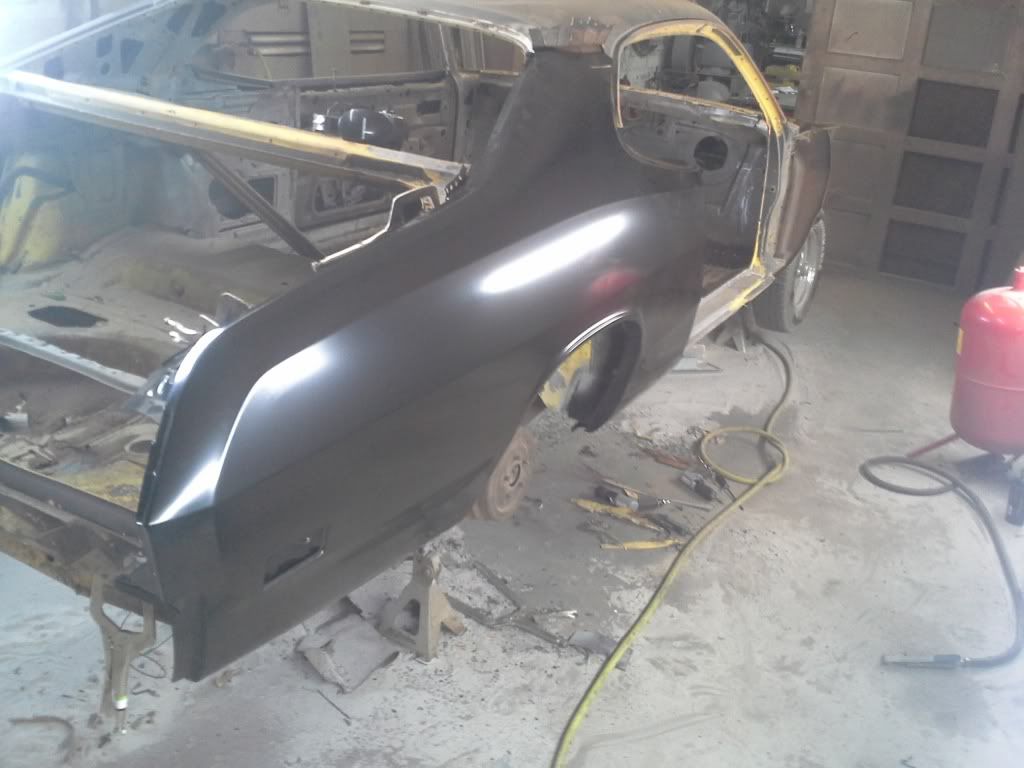

So I made alot more progress! I currently have the new left rear quarter welded on and have started drilling and using a spot weld cutter to remove the right rear quarter and found alot of more rust......

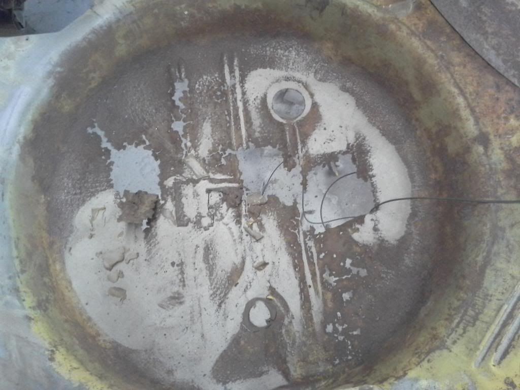

This is what I found under the right quarter.....
the repairs begin...

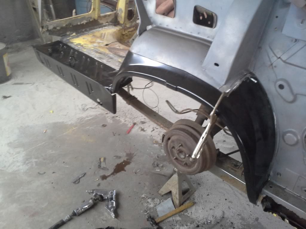

I Then decided the trunk extension, the trunk gutter and most of the outer wheel tub wasn't worth saving... So I ordered more new sheet metal from dante's mopar....

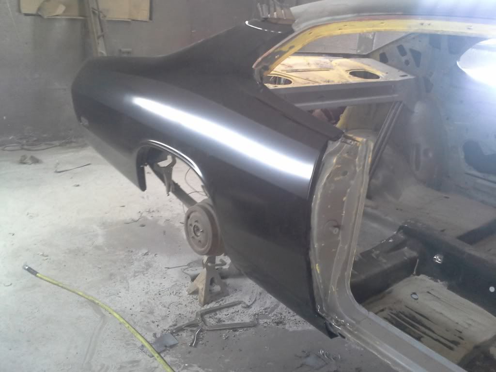

looking good. how did the quarter install go? any issues? im about to attempt that in a few weeks
if you could post a few pics of the seam at the roof, that would be awesome : ) what do you plan on putting back in that seam?
Not really any major problems fitting it just time consuming doing the fitting. I plan on using short hair dyna glass to fill it and then use Z-grip light weight body filler.....

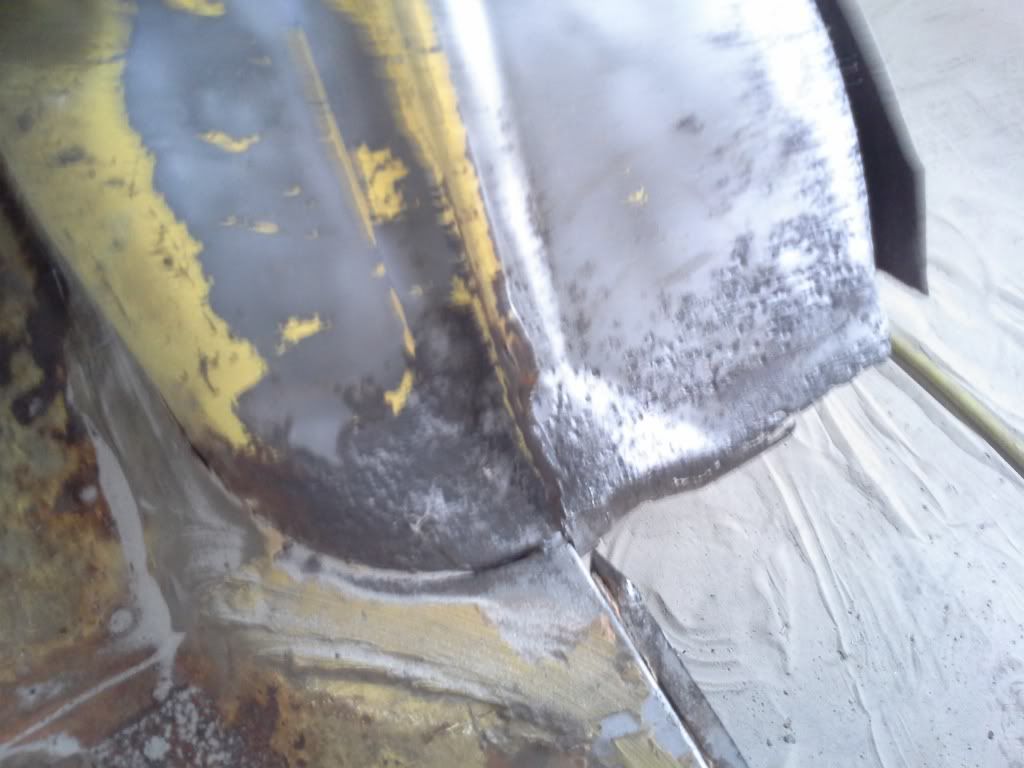

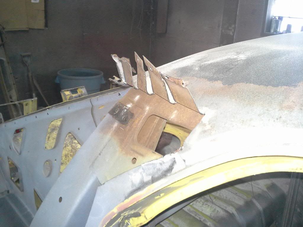

here is a pic of the roof seam...
this is the right side but this is what i did. This may or may not be the right way to do it but it worked for me..... I made 4-5 cuts and peeled back the roof and then bent them back into place and welded them up and ground them down...
You can also see in that pic i left some of the old quarter right behind the window... I used that to seam the new quarter to the old one....

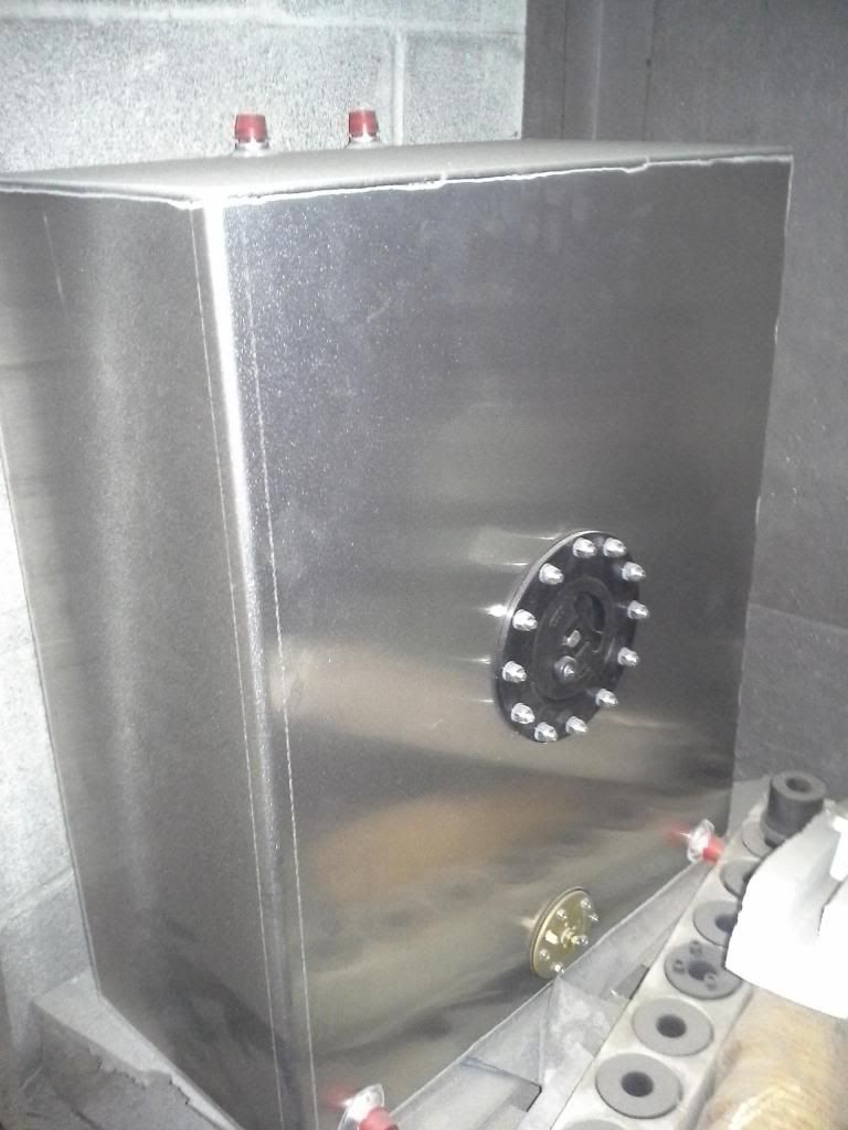

I really hate the fuel tank and vent set up in this car so I have a plan to fix this.... I'm going to cut out the spot for the spare tire and and build a box out of sheet metal and drop in a 20 gallon fuel cell. I have a bead roller so i'm going to lay some beads in to try and match the look that's back there and add some strength....

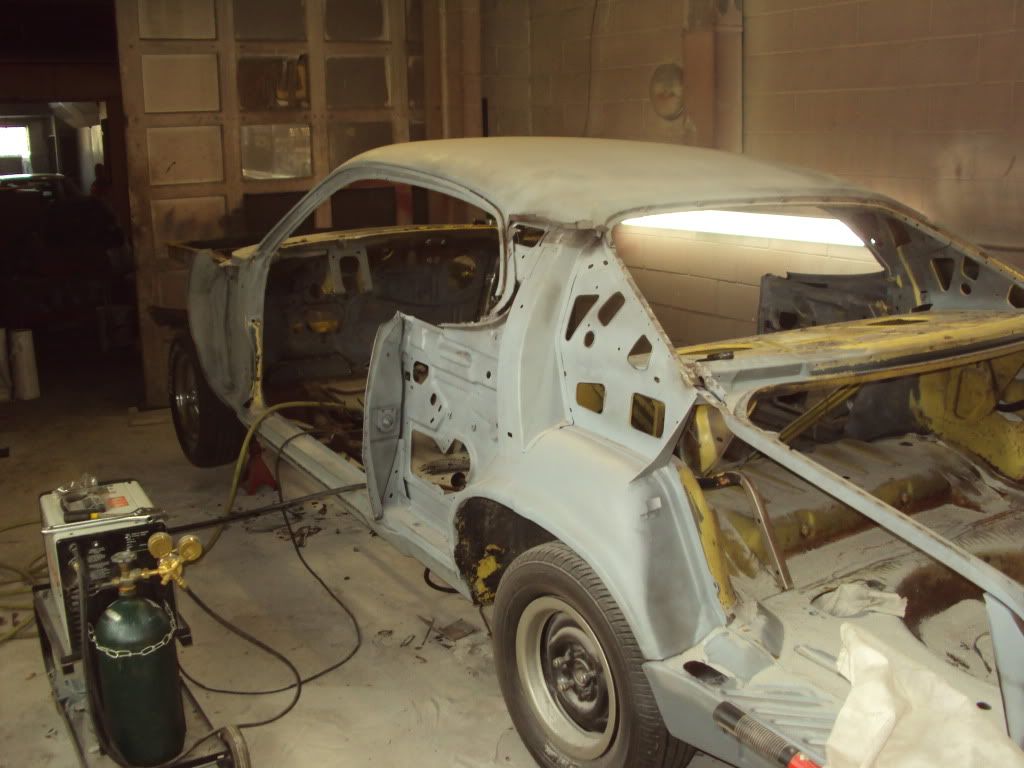

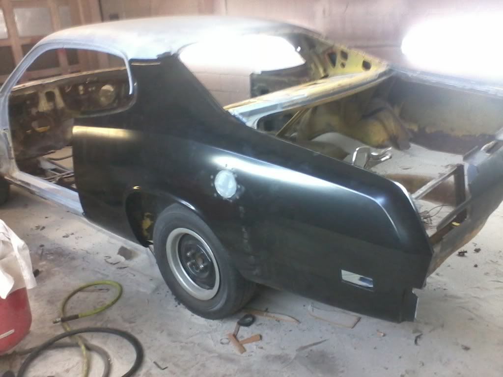

After a couple hours of grinding I was finally able to test fit the right quarter today... It doesn't fit bad but its defiantly gonna fight me more than the left side.....
And now that I know the quarter will fit with a little massaging i can start welding everything behind the quarter....
just wondering, why did you have to peel the roof back?
The quarter is under the roof panel so when I used a spot weld cutter to get it loose it leaves part of the weld sticking up and with the roof panel over the top of it it makes it real tough to get the old panel out and grind it down and then put the new panel back in the same way with the roof over top of the new panel... Like I said this may or may not be the best way to do it but it worked for me! Ive never seen it done before so im figuring it out as i go.....

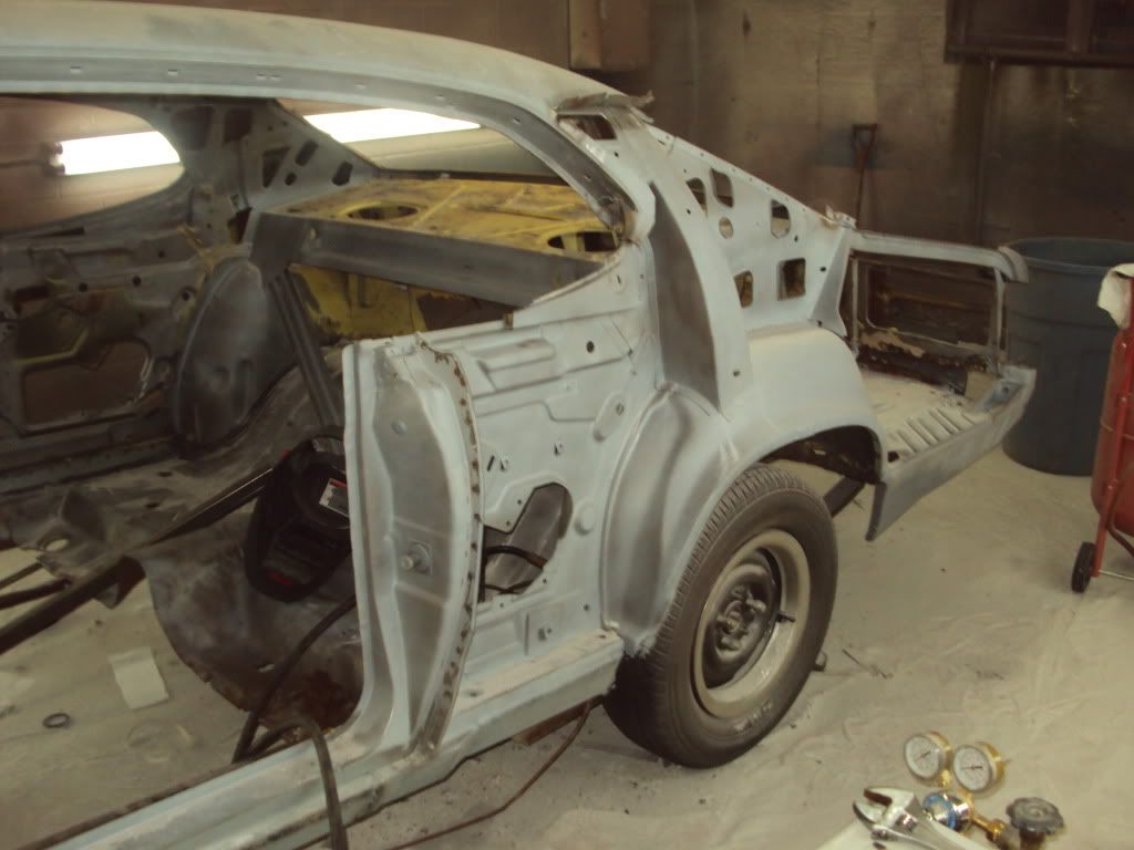

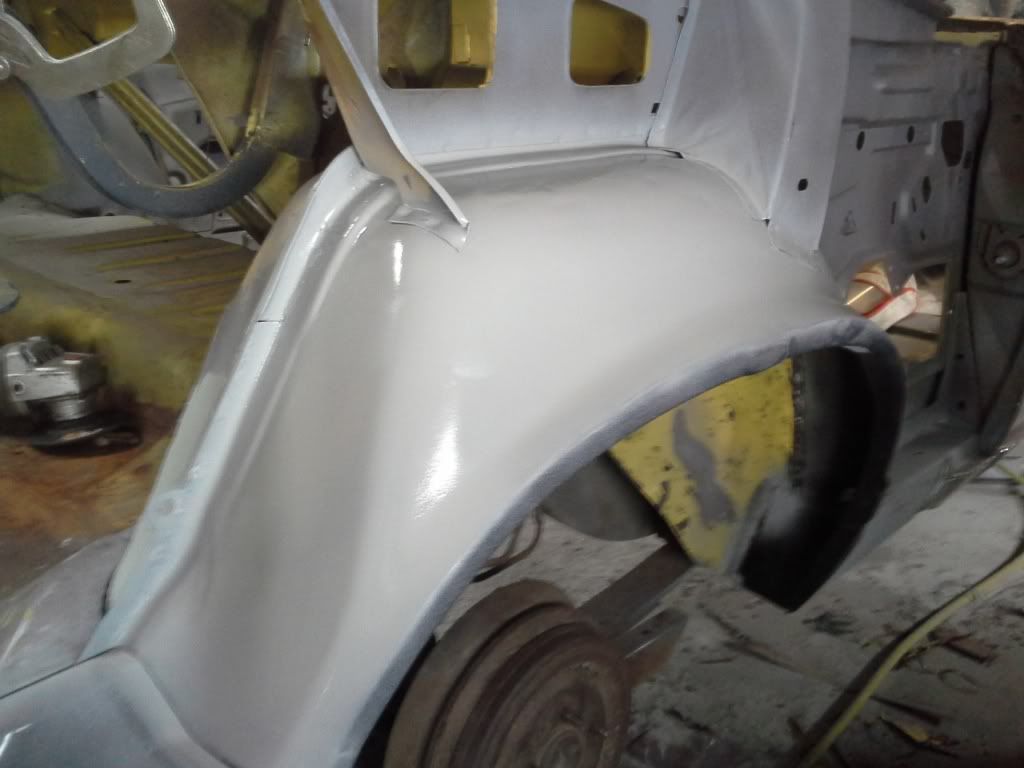

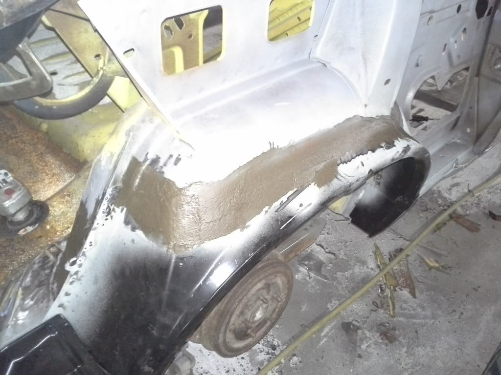

Today I got alot more done on the outer wheel tub and I welded on the new trunk extension...
I used short hair dyna glass to cover the ground weld...
After sanding...
Then put on some Z-grip filler...
After sanding that down I used some high build primer and this is how it turned out....
