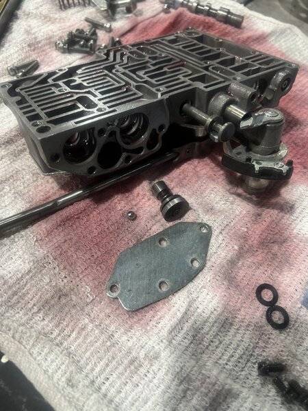

Does anyone know where this check ball goes? I pulled this side cover off and the piston out, tipped it up and the check ball was laying there. Not sure where it goes. It’s a small check ball, already removed the large ball

Follow above link then look for instructions on the left. Click and find 17156 drawings in pdf format. Hope that helps
