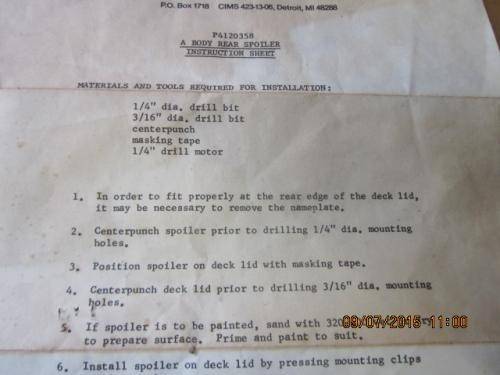

I can't say that I've ever seen any additional bracing sold with the DC spoilers. So, the flex is probably "normal", but that doesn't mean it shouldn't have more bracing. The rear ducktail DC spoiler was just held on by plastic push rivets, I even have a picture of the instructions for that one. Nothing about the front one though.
