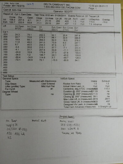

I have added this for documentation on the cams that were used for this project... I bought them from another FABO member who had them custom ground, they are not factory original or Mopar Performance cams but were ground to the factory specifications....
Here is the PM info that I got from the Member who sold then to me, he was in Washington...
Here is the cam that was ground to the stock 340 automatic cam specs...
Per the 68 Plymouth service manual, the factory specs are:
268/276 dur, .429"/.444" lift 44° overlap
Here is my tag with the info that I did when I degreed them myself....
Here are the markings that were on the end of the cam...
Here is the layout data from Ken when he put them on his cam inspection machine....
Here is the cam that was ground to the stock 68 340 4-speed cam specs...
276/284 dur, .444"/.453" lift 52° overlap
