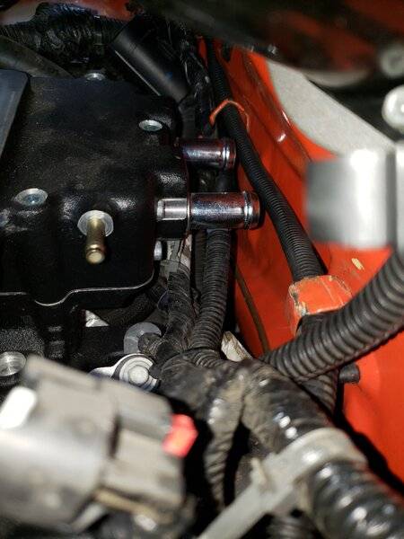

Recently I've played around with some Edelbrock superchargers.
I test fitted a standard TVS1320 Wrangler unit just to make sure there weren't any interferences.
It clears the 2 Speed wiper motor!
Only real complication is that the water nipples for the Water/Air Intercooler are too close to the firewall.
View attachment 1715940953 View attachment 1715940950
