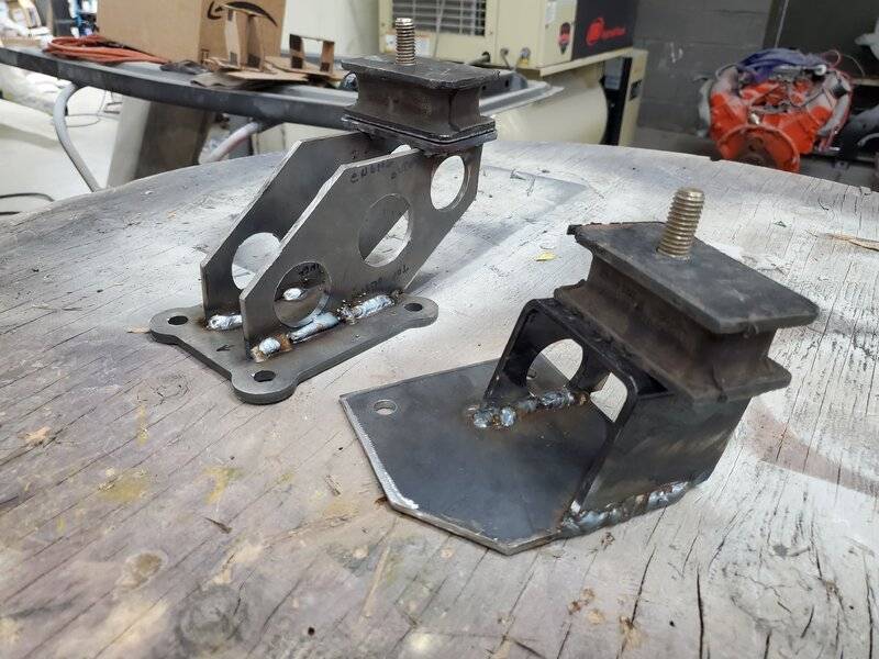

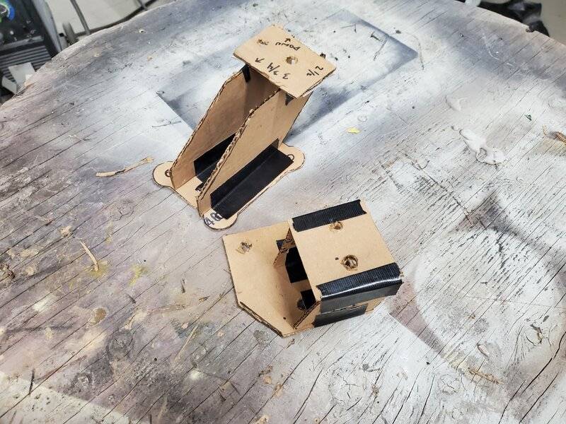

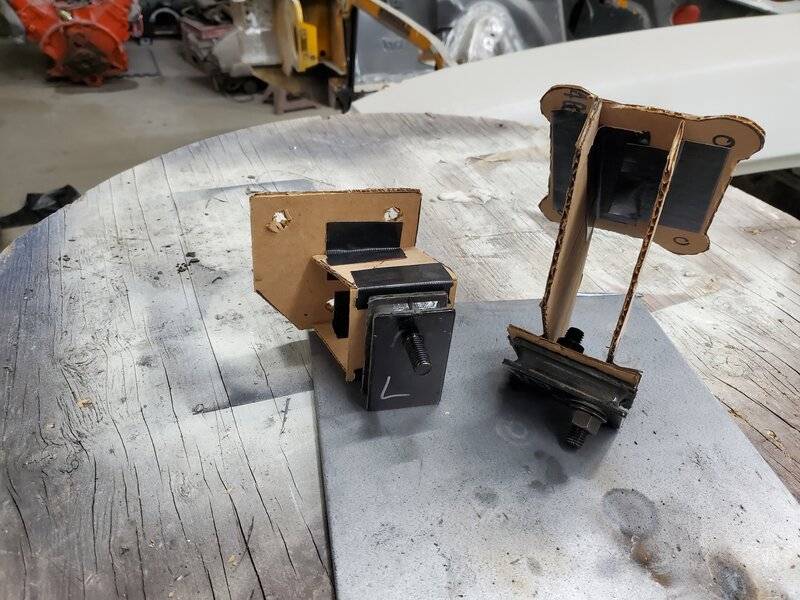

I have just built a set of mounts for my 62 lancer 6.4 swap. After making a cardboard model, and actually bolting them in place. I was able to cut the pieces from 3/16 plate and weld them together. I used rubber mount insolators, (part #2265) in between the brackets and pad.
