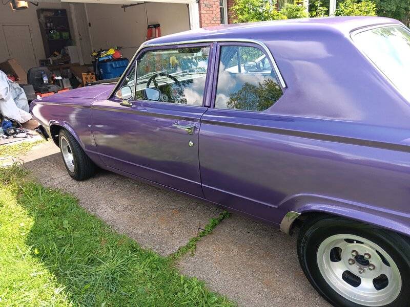

THat's a poor pry bar image but you should get the idea. Stick the pry bar between the floor and the shackle and the shackle mount and pull up. That should invert the spring and shackle on the bottom side of the mount the way it should be. It will take a long pry bar. 4' or better!
I just picked up a new to me 1965 dart and I'm trying to figure out what rear springs I have, it seems like the shackles inverted a long time ago but they never tried to fix it and I don't know if it can be corrected or if the springs just need swapped out. I've attached some pictures for reference, it has a really aggressive rake to it but I can't figure out how much of it is the spring and how much is the tire. Right now it's running a 185/70/14 front and 205/75/14 rear. Any ideas on what I've got here?
