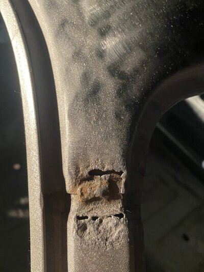

The original A pillar to roof seams have been patched and seam welded rather than lead whipped or bog to avoid cracks with power being put through the A body, same was done with the roof to quarter seams. One side had some signs of rust

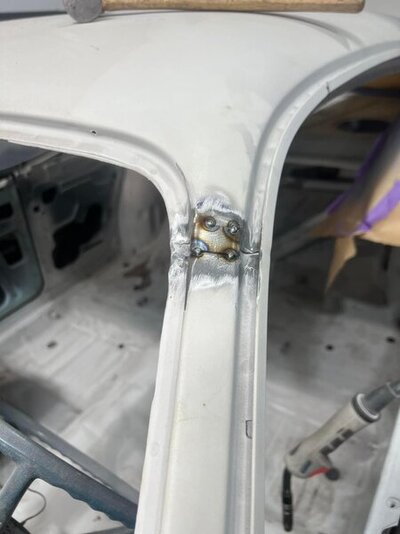

Cut out and patched hopefully stronger than original and less chance of getting the common hair line crack
