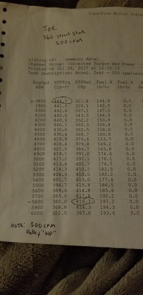

Here is another airflow limited dyno test of a oval track 360 I did 7 or 8 years ago. It's a .010 over zero deck stock stroke 360, with a .420! Lift hydraulic flat tappet cam (class rules) a set of EQ magnums, no porting allowed, but bunch of time spent on the valve job, a shitty edelbrock performer 318/360 (class rule again) and a 500 holley two barrel carburetor. 1 5/8 garbage headers.
Very impressive for the pieces used....
