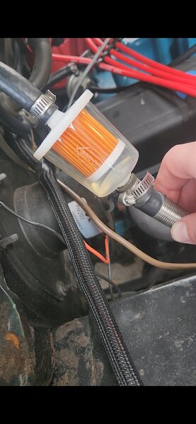

I'm aware a fuel filter doesn't need to always be full, but do you agree this empty (first pic) is a problem?
No that looks fine to me.
For an experiment, you can reorient it so that the fuel comes in at the top and exits at the bottom. The car will run, and there will always be a little fuel at the bottom, but it won't fill up.
This was with the mechanical pump, and after it cooled down slightly with the hood open and running. It would start pumping tons of bubbling fuel into it then the bubbles would clear out.
It shouldn't be pumping air. If you have a pinhole (or three) in your fuel lines, or an equivalent leak in any of your other fuel connections, on the suction side, it can break the vacuum, your pump will suck air, and you will have all sorts of running and starting problems.
(If the hole is on the pressure side, you will have leaks).
