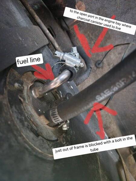

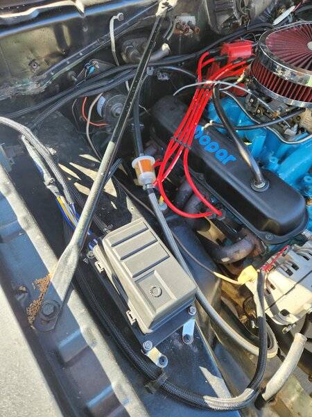

First time poster here. I just bought this Dart a month ago, and it was my first experience with old American cars. I've fixed a lot of small things with the help of the search button on this site, but I'm running into a problem and I can't find what I need without posting. This is a 1975 dart, with a 360, and I've got a fuel boiling problem. I started with an electric fuel pump install, this helped but didn't completely solve the issue. Which is, whenever I'm stopped in traffic or make a quick stop at the store, and fuel is sitting in the lines, not moving, I'll take off again and I get a massive stumbling problem. Before the electric pump, the fuel filter would be essentially empty all the time when it was hot, now it is filled up a bit more, but I still have stumbling issues when I park for a few minutes then go back and drive. I think the electric fuel pump helps keep it under pressure so it doesn't vaporize in traffic, but obviously can't do that when I'm parked. So now I'm looking into adding one of the wix filters with a third outlet to lead back to the tank, so the vapors can escape if and when they build up. My charcoal canister is long gone and I have an open port up in the engine bay. I feel like I've read conflicting reports if I can use this as a return. Can I just plumb that third nipple of the filter back into the line that used to go to the charcoal canister and add a vented gas cap? I don't see why not, as long as I can find a gas cap that vents under pressure and vacuum, does one exist? I also don't know what kind of fuel sender I have in the tank, because one port is completely blocked off and I'm not sure what it was originally for? I could use rubber line to connect the blocked port to the hardline that goes up front, and use some rubber line to direct the "original" vent to atmosphere. Or vice-versa, or use a vented cap if I can find one. I'd appreciate any advice, this ain't a race car or a show car, I just want to drive my dodge with the dog and not have annoying stumbling problems. Thanks yall! I added some pics of my fuel sender, the fuel pump install that is running through a relay box and fuses, which is all running through a circuit breaker, and a pic of the dog that just wants to go to the park.
I read most of the comments hear, but never heard of the old word, "Vaper Lock". Heat along the fuel lines is one cause. That is what you are getting. Heat from the headers, along the side of your motor is one I see here. The fuel line from the factory, for a reason, comes up from the front of the motor, where it is a little cooler. The same for your after market electric fuel pump, with the lines being close to the muffler. I would install that pump closer to the tank, away from any heat source. The biggest issue is the fuel you are using. Winterized fuel, which is what is being used now, all over, including Florida, where I'm at, vaporizes easy. Carburetor cars have a problem with it, fuel injected ones do not, because the fuel in them are pushed thru the lines and not drawn. BTW, I'm talking from experience here, I also "HAD" that problem. You can also go to non-ethanol fuel, which may help.
