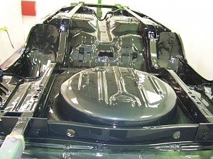

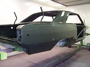

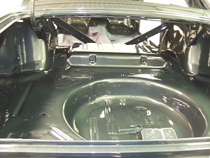

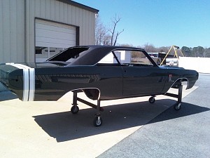

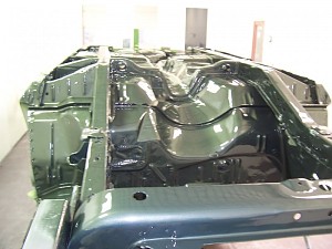

Pics of paint work just being finished, painted original GG1 racing rally green.
Car was media blasted prior to metal work. Metal work consisted of both rear quarters, trunk extensions, fill in holes from fuel cell in trunk and fenderwell headers.
Also installed spring relocation kit & moved rear axle aft to center in wheel well, and mini tubbed. Installed full frame weld in frame connectors.
