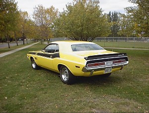

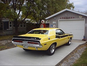

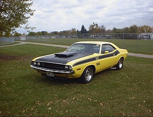

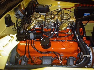

The car is done to look stock at car shows but the drive train has been changed. The origional trans was gone so I have a B&M racing 727 with a 4000 RPM stall converter. The rear is an 8 3/4 sure grip with 4:88 gears. The motor is stock looking also but has been built using 12.5:1 TRWs, Crane solid lifter cam with a .600 lift, the dist has been recurved, it has a Milodon oil pump, and uses the OEM T/A heads. The carbs are also reworked also.
