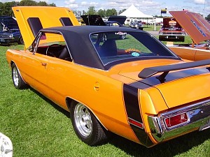

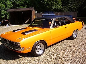

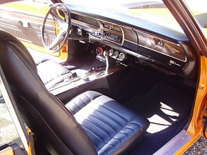

here is a 70 dart GT . it came with a 318 but now has a 360 with a 904. bucket seats and center consal 8 3/4 rear end with 355 posi .disc brakes from a 73 duster . rear leafs were moved in a 1 inch on each side . a 70 dart GT is a dart custom with the GT package witch reads A65 on the fender tag.
