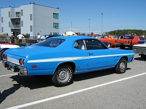

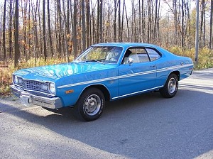

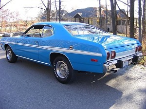

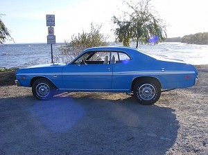

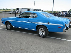

1973 dodge dart sport 340 4 speed.372 stroker dynoed at 452hp 440 ft.pounds 12.89@108mph last launch snapped an axel.8 1/4 to weak.i,m building 8 3/4 4.10 gears in a 489 pot with bbp strange axels and a new centreforce dual stage clutch.i,ll be posting new times soon after i get to launch it at a better r.p.m.Oh ya also slide-a-link traction bars
