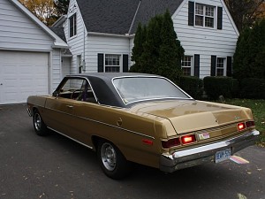

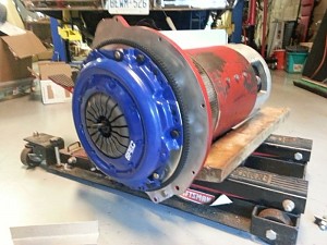

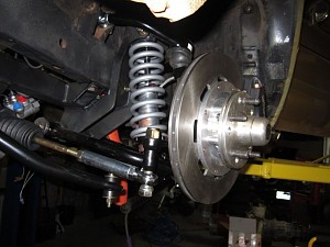

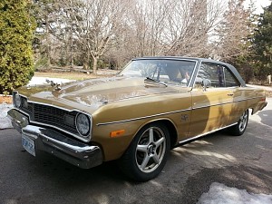

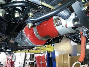

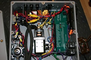

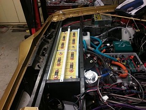

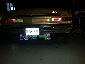

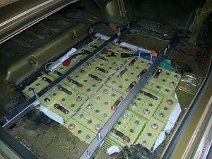

So this is my 100% electric Dodge Dart Swinger
The car has the Bill Reilly Alterkation with Wilwood brakes and power R&P, Hydroboost plus Wilwood master cylinder, electric brake pump, led headlights, 5 speed chevy s10 nv3500 transmission with stage 4 clutch, 8 3/4 rearend with custom Moser axles, Caltracs plus split mono-leaf springs, 50 180AH lithium iron phosphate cells from Thundersky, Warp11 series wound DC motor from Netgain, Zilla 1Khv...
