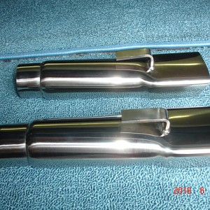

came out great

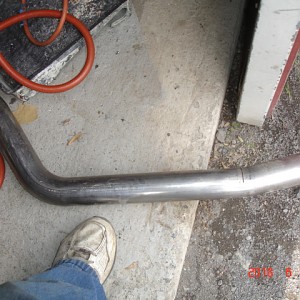

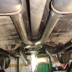

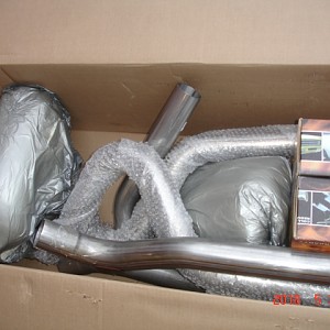

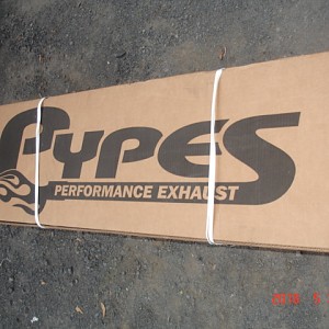

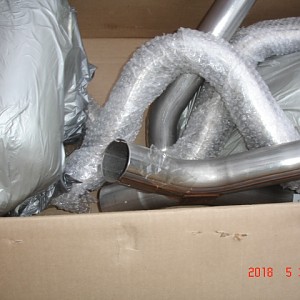

exhaust was a PITA the system is not BARRACUDA friendly
1had to widen the X pipe
2 pypes should have a BARRACUDA only over the axle tail pipe (considering that they are all computer bent)//you have to cut at the 1st bend over the axle (the pipe should be straight and follow the frame rails) these other bends might work on darts / and dusters but not BARRACUDA's
used tti down pipes to the X pipe yikes!!!!!!!!!!!!!!!!!!
3 if I have to do it again (stain less) I...
