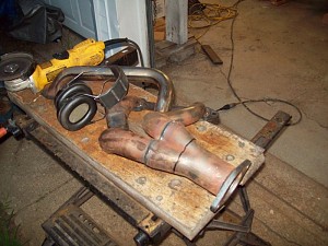

So I'm going to use Schumacher try-Y headers on my 440. I have enough engine to probly make at least 550 HP with full length headers but as we all know, big headers in a big block A body are a problem. They cost alot, are difficult to install and they won't work with power steering. Fenderwell...

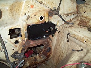

Note. I assume no responsibility and or liability for anyone following this procedure. This is for advanced fabricators with strong welding, fabbrication and engineering skills only. You assume all liability if you opt to relocate your master cylinder. Here is a pictorial of how I relocated the...

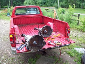

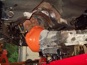

OK, here is how I fitted an A-518 into the car. After i got the 440/727 intstalled and levelled, I set up rigging to hold up the rear of the engine so I could remove the 727 and go ahead with the A-518. I loosely followed Gdonovans A-500 install thread. Its a big job because the OD trans will...

If anyone has seen any of my posts on FABO then you know I've been a flip flopper on alot of things I want to do on the car. The transmission has been the item I've changed my mind the most about. I originally wanted to go for either a Kiesler 600 or a Passon A-855 5-speed but because of cost...

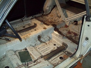

For frame connectors I googled steel tubing and shopped around untill I found a good deal on 2 1/2x 2 1/2x .063 steel tubing and ordered it along with a 1 ft x 2 ft. piece of 16g sheet metal. A little time and effort and I had the floor notched and had the tubes in and completely notched into...

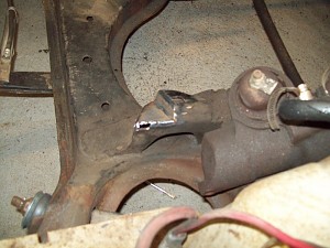

The Schumacher conversion mounts came with instructions to notch the L.H. enginr mount stand to clear the B/RB oil pump. The size and location of the notch varies depending on what brand/size oil pump being used. My solution was to put one big notch into it to clear all brands/sizes of oil...
