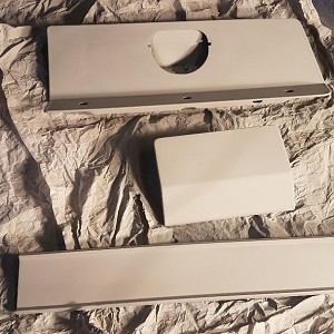

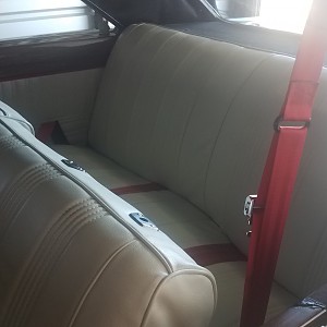

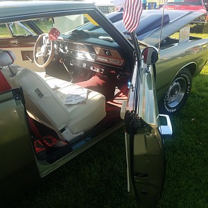

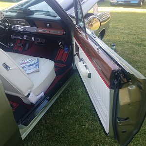

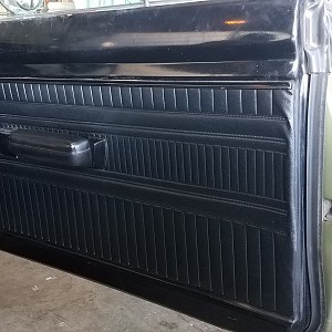

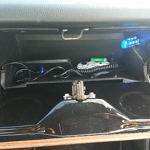

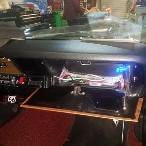

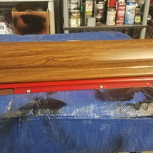

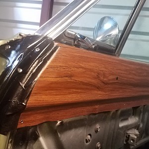

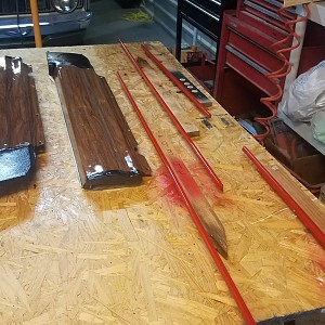

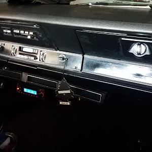

A transformation from Blah Blah black to something that never was, but could have been. 70 Duster door panels, 70 dart Custom seat jackets, custom 3M simulated accents ( marine teakwood) and red on upper door trim and glove box. Maroon carpet

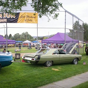

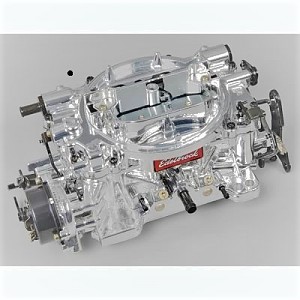

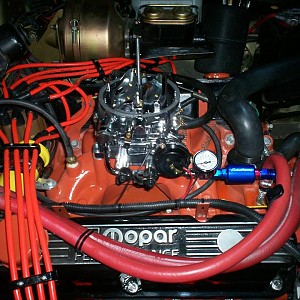

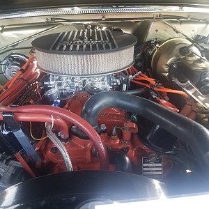

An "H" Code car that now uses the long ago 1992 P4529784 Lopy (2800-6200) 360 super commando crate that was featured in the oct 92' HOTROD MAG crate shootout that Dick Landy used in a duster with 4:10's that did mid 12's, Air Gap intake, 800 edel (ele choke) dual feed, edel mech 110 GPH fuel pump with the original 4 speed, centerline clutch, 8000 rpm Ign box, Accel 45 K coil 8MM wires, NGK iridium plugs, Hooker super comps & Flowmasters. I drive this car using 3:23, outstanding low end...
