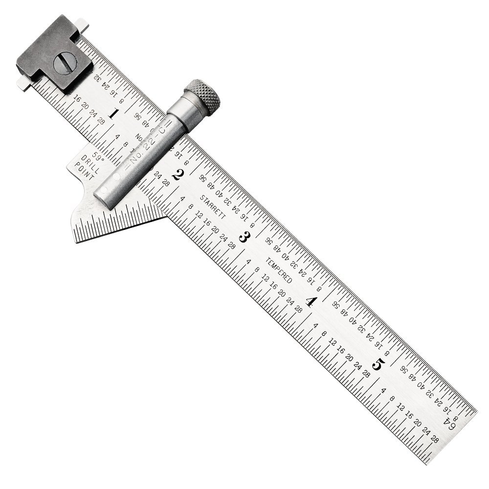

There are adapters to mount on your bench grinders to do it with the right angles
you can find a drill point gauge to help with the angles and to keep the lips even and the point on center.
