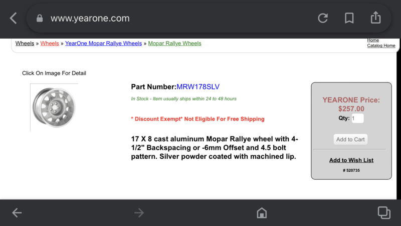

I realize that this will require a complete tire/wheel change from 14” 5 on 4 to 15” 5 on 4.5. I plan on purchasing Year One aluminum Mopar Rallye wheels. Front & rear size/offset recommendations would be appreciated.
Those are 15"? Also, you might want to rethink that. The front front offsets do not work well at all with A-bodies. Those were designed for B & E bodies.

Thanks for the reply. Sorry if I was unclear on this. The pic shows the factory 14” wheels. The kits I have researched indicate that they are made to fit 15” - 5 on 4.5 wheels, and are designed to accommodate the deeper backspace/offset. I will confirm this prior to purchase. I appreciate your response.

This is the aluminum Rallye from Year One. They are 17”. The 15’s are steel.

Thank you for that explanation. I was mistaken on the wheel size. I will research per your suggestion.
