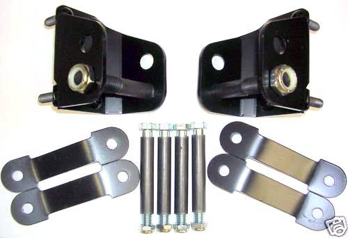

I would instead put on a offset shackle kit from
Mopar or Dr, Diff.

That would definitely be a better plan, although it would require moving the spring perches.
Thanks for the advice, I will take a close look at spring location kit.
