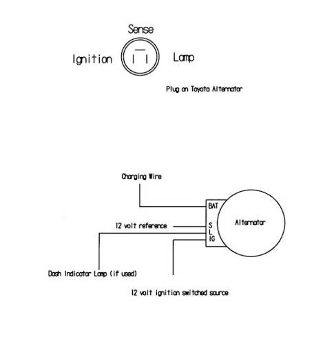

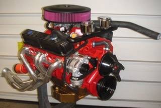

i think it would be easier to find the toyota 4 runner denso alt. i'm running on our dart then the stock style one.
i'm all for the internally regulated alt. the little denso puts out 14 at idle.. no more dimming headlights at idle..

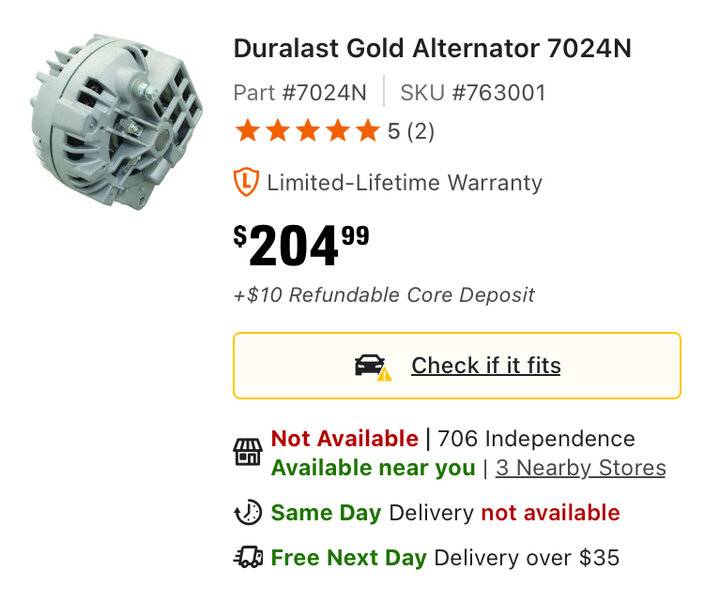

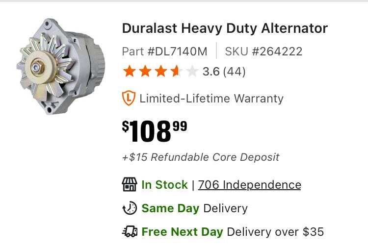

It seems like you haven’t tried to buy OEM parts from ANY local parts store from ANYWHERE since February 2020. Good luck finding a round or square back that is in stock. I honestly don’t remember the last time I got an OE part in a day. Consumables and universal parts is all parts houses seem to have on hand these days.
The whole argument is dead, “Keep it stock so you can get parts in Anytown, USA if you break down on a long road trip.” :BangHead:
Exempli Gratia:
Not available:
OE replacement
In Stock:
Toyota unit for AR Engineering or modified stock brackets.
