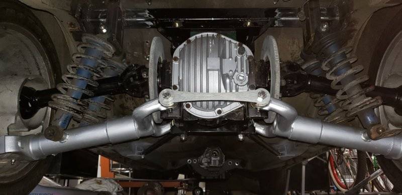

Made some good progress this weekend. Finished the bones of the Rearend build, have a few small things I would like to do before I'll call it finished. But for the most part is done. It sitting on its wheels holding its own weight. I'm super pumped about that. It's sitting a little taller than I want but it also doesn't have a gas tank or interior in the car, Also the springs haven't held weight in quite a few years so I'm expecting it to sag a bit which will should put me right at the ride height I want...

One of the hardest parts of this damn thing was finding the right tube for the upper shock mounts.
I wanted a thicker tube to carry the weight but also need a tube with the right inside diameter. I couldn't find the right tube to save my life.
I ended up using a 1" seamless 1/4" wall tube and pressing in a 3/4" x .065" stainless tube than cutting to the lengths needed for the upper mount.
This ended up working out to my advantage. Not only do I have the strength and the wall thickness I wanted, but I also have the stainless property of the inner tube which should make the removal of the shock pins easier in the future.
Come on now, let’s see a side shot so we can see that ride height!
Btw, that shot from the rear looks absolutely killer! You’re doing an awesome job!
That is some pure badd-*** fabrication and hot rod building right there!
Awesome. You should produce those now that you have it down. If you need a gen 2 Cuda I will gladly donate mine
nice job on the jag irs install. are you going to fit 'torque arms' between the lower arms/wishbones and the chassis?
neil.
Yes working on that and a few other things at the moment. I have the stock jag torque arms and using them to help me figure out my set up for building my own. Adapting them to the barracuda shouldn't be too much of an issue. I just need to figure out the mounting to the frame. I was thinking of using the stock style bushings to account for the movement needed? maybe I don't know yet..

Nope stock style tank, and yes the diff will be for the most part hidden by the tank. gotta take the good with the bad sometimes.
