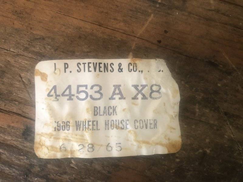

I did check around a little on the existing carpet and found this sticker. Pretty cool
