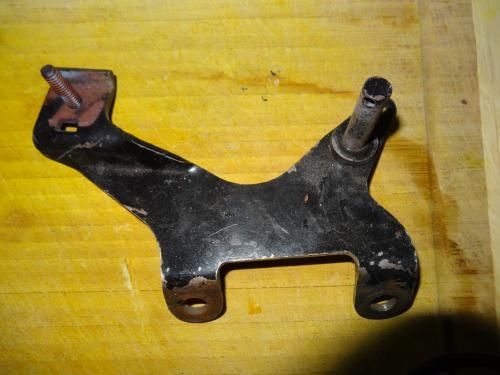

As I posted earlier, the 340 throttle bracket is part number MRE 0060 at Mancini Racing...
318 Bracket:
thrtl-bkt-a07-b-jpg.1714869273
340 Bracket:
thrtl-bkt-a08-b-jpg.1714869274

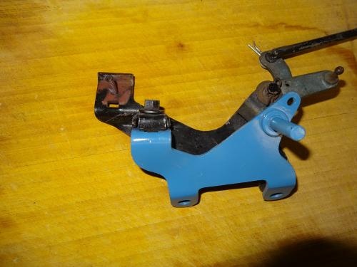

Comparing both with the mounting bolts lined up:
thrtl-bkt-a03-b-jpg.1714869275
thrtl-bkt-a06-b-jpg.1714869276

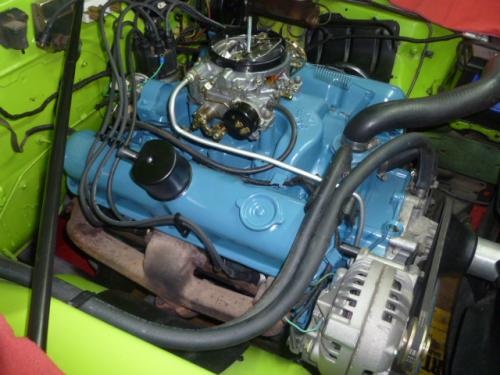

Pulled all the spark plug wires off this morning & used an exacto knife to clean off some old overspray (Not mine) :)
Then cleaned with brake clean & installed them in the freshly painted wire looms. They came out nice.....
Make sure to use composite Intake gaskets(dissimilar metals) alum vs iron. I used Felpro.
I used the Fel-Pro 1243 gasket set.

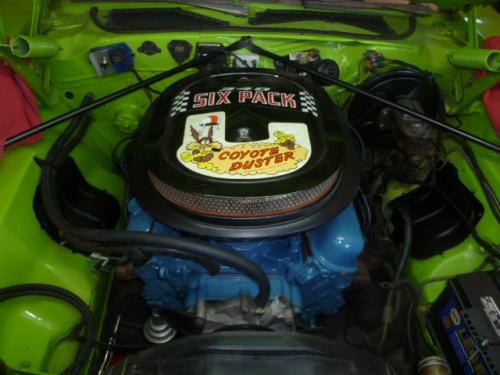

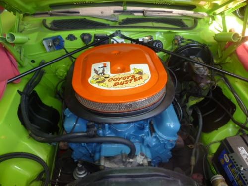

Just fooling around with air cleaners a bit. Ignore the sticker.
I think this could work in black with a little creative fabrication :)
Missed your post. Love the big oval air cleaners. Fresh air would even be more fun.

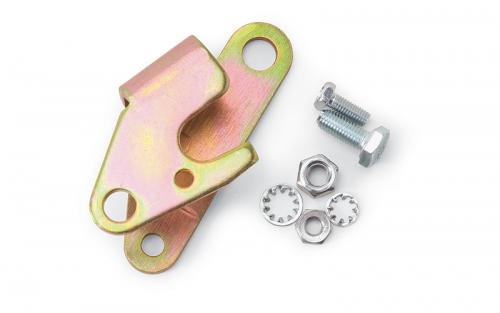

You need the correct kick down lever. I looked it up in the Summit cat. It's called a Chrysler, Universal Fit EDL-1481. It will help to align your kickdown.
Just a side note. Actually I'm repeating a previous post.
Key words, "4 spd car!"
It's a 4-speed car, so not needed I believe....Thanks
I go though this a lot. Even with the hood open. "Dude! Your missing your kick down linkage! Your gonna burn your tranny up man!" :banghead:

from a visual design perspective... having the air cleaner the same as the valve covers and/ or intake is the way to go... although i think the covers and cleaner being black look better... personally.
orange looks weird alone.
I like the blue also.
Orange - reminds me of smacking my thumb with a hammer. :)
Blue - too much blue already in the engine compartment
Black - Looks best and carries some contrast with the other black elements in engine compartment.
Is pink an option for the girlyish elements of the build? LMAO
x2
The factory did a blue engine and orange air cleaner. WHY-o-WHY! I don't know.
A bit off topic ( I do prefer black for the air cleaner btw) but please paint the water pump engine color! When did that trend of drawing attention to the water pump start?
Gag...
