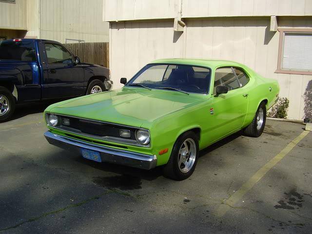

        255s are a nice size tire, here they are on the back of a B.

                        This is my car 275/60/15 on a factory 15 x 7 with 4.25" back space, plenty of room between the springs and 1/4 panel. No spacers.
