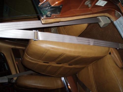

I bought aftermarket 3 point retractable belts from Wesco Performance. I am very happy with the way they work. I had to mount the retractor on the rear floor right where the seam is.

qkcuda....looking at your pictures I'd be replaceing the reinforcing plate you used.....norm is 3"x3"x1/8th" minimum, as Mopar floors are thin I'd go bigger again!! check your local regs but I'd be surprised if your plate is legal...stay safe, Marty
