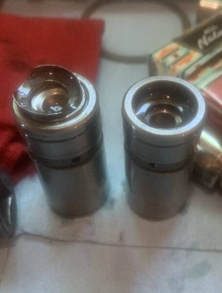

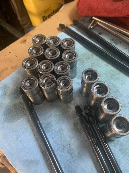

                  Don’t use Comp Cams lifters. After cam break in...
                  73BC9D2F-CF2C-4452-B8D0-DFF3D34D3828.jpeg 8D51CE33-BEB1-49DD-8FF8-37056C2DA1B6.jpeg
