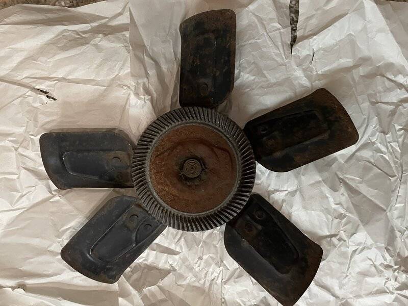

Looking to my ABody Friends for a little help,
I’m rebuilding a 1976 360LA engine to put in my 66 Barracuda.
I found an era correct Mopar Viscous 5 blade offset clutch fan that I would like to use on this engine. I’m having a problem finding a replacement clutch where the shaft of the clutch will line up with the water pump pulley bolt holes.
Is this even a possible for this SB engine? Suggestions?
I would appreciate any insight on this issue.
Thanks
Dwayne
Are you SURE what you found is for an LA small block? Most of the clutches have slots. So unless the slots are not spaced equally, it should fit most water pump bolt patterns. I actually don’t think there are different patterns though.
^^Agree.
A bigger concern would be which water pump/tc cover you're using- '66s were designed to use the (pre '70) cast iron water pump (driver's side inlet) which is considerably shorter than the '70 and later aluminum water pump (pass. side inlet). I'm not sure you'll be able to find a short enough fan clutch to fit the long-nose aluminum pump in an early A body ('66 and earlier-smaller engine bay than '67 and later), especially if you've got a thicker than normal aftermarket radiator.
The Hayden #2947 fan clutch is about the shortest one I know of (although I've read rumors of an even shallower MB clutch, but can't verify) if you intend to go with the late water pump; and even that may not be enough. The early iron pump should give you sufficient clearance, though.
I have the MB clutch unit IIRC. Running it with a 68 pump. 3/4” from the original 340 A/C radiator.
I’m running the newer water pump with the passenger inlet. I had the original radiator re-cored to handle the extra horsepower. The old 66 273 had the fan blade attached to the water pump pulley with 2” spacer. The bolt pattern of the clutch is off about 3/8” from the water pump pulley. The water pump from both engines have the same bolt hole patterns. Am I stuck using a non-clutch fan—flex fan? I’m not racing this car.. just a weekend driver..
Appreciate the help..

I used the Hayden 2947 on my 69 with the same 360. It works great, but clearance is very tight to get the water pump bolts in. I had to use studs with locktite in the water pump.
