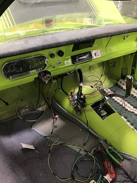

@goldduster318 did this conversion here and started with a 4 speed tunnel.
img_20180910_131341355-jpg.1715222331
