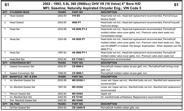

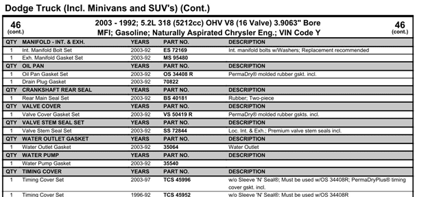

I am planning a 5.2 magnum swap. To install the 360 car pan on my 5.2 magnum, do I need the 5.2 magnum gasket or the 5.9 magnum gasket? I thought the all the magnum pan gaskets were the same, but there are different part numbers for the gaskets....

I thought that might be the case, so I went straight to the FEL-PRO catalog, and sure enough they are different parts numbers...
They differ. Just like the older 360 cu in, the 5.9L has a larger rear hump, so different oil pan and gasket than the 340, 318 (5.2L), and 273 cu in engines.
If you are putting an LA pan on a magnum, you need an LA 360 gasket, unless you want a leak. The pans on magnums are all the same, 5.2 or 5.9. The gaskets are different, my guess it was to use one pan on both 5.2 and 5.9.
