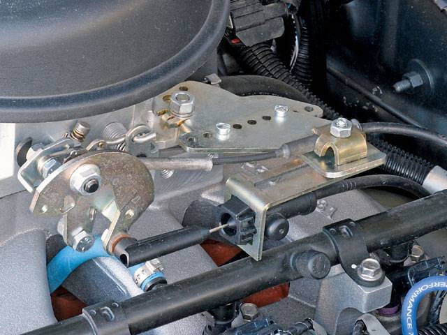

This one is on the 4150 type intake on an earlier hemi, but gives you the idea of how you could fab up a bracket.
and one on a LS, which has the same type front TB setup
I haven't used the pace 5.7, but I have a cable driven early 5.7 I used to have a 727 behind. (Now it's a 200r4). I used the lokar kickdown cable, and had a bracket made... I know I've posted a detailed description more than once. Maybe search my posts...
I attached the cable to the TB cam at an extra hole.
I then measured how much the cable moved from idle to WOT.
I then moved the kickdown lever from zero to full, and using some sort of redneck math I determined at what location on the kickdown lever I needed to drill a hole (closer to the trans than factory) so that with WOT I had full tension on the kickdown lever, and yet no pressure on it at idle.
Here is another pic of mine how it sits now with the 200r4 TV cable geometry. It's the best pic I have of the bracket I made, the bracket is the same as when I had the 727, just the attachment point on the TB changed to meet the Criteria of GM's TV cable.
