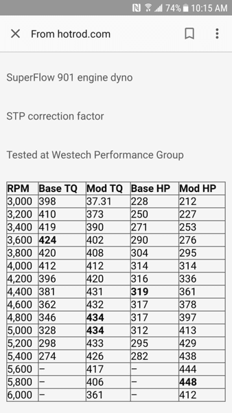

This is a stock 380hp crate engine, stock longblock M1 single plan 750 holley headers and something like 231/236, 288/296 108 .513 lift cam
Here's 300 hp crate stock long block and cam dual plane 750 and headers and Mod is ootb eddy heads and a comp 275 roller and airgap.
