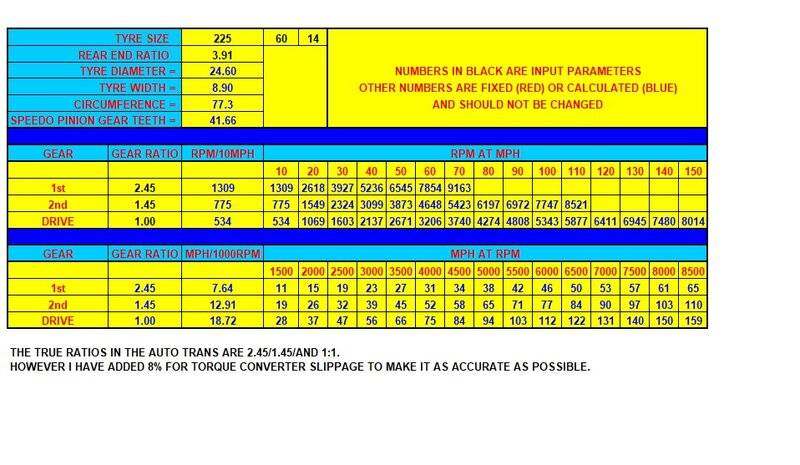

With apologies to the OP for a minor hijack along these same lines.
Has anyone used one of these to calculate gear tooth count?
It comes up to 41 tooth... Which based upon the follow-on charts is accurate as I've used navigation apps to track speed and compare to tach.
Seems off to me. What am I missing?

Never seen a calculator that works for Early A's. If it has a 41 tooth, definitely not for our cars.
If you don't have a technical service manual for your year you should really have one. That's probably what's missing.

View attachment 1715982329 View attachment 1715982330 View attachment 1715982331 View attachment 1715982332
Thanks for the pictures... looks like maybe a 19 or 21 tooth . Just what I needed

But 64 only goes to show 3.31 or 3.55 axle ratio so trying to cipher an appropriate change to match things up with the 3.91 I have now.
T
The '65 chart above shows Grey and green for 391s. Next step higher would be Dark Blue 19 and then dark purple 18 for the 904.
