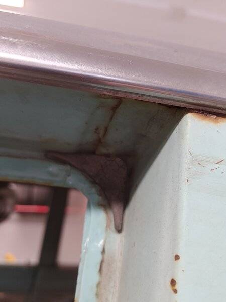

Thanks. I was actually looking at their site for a lot of stuff. I was also looking at Dante's for the window rubbers. Their part number lines up with the steele part numbers. Had anyone dealt with them? Thoughts? The one part I haven't located yet is the door weatherstrip. Also there is a little triangle piece of rubber or foam at the top corners of the door openings (will post pictures later). These are clearly 2 door post parts (maybe 4 door as well?). Any one know where I can locate these or what they are called?

I am going with black interior with gunmetal paint with green outside. I have seen the black windjammer weatherstrip. What I am looking for goes on the leading edge of the door. Also the little triangle from the top corners. My car is original paint and never been apart so these seem to be original.
I have pulled doors and B pillars from a 66 2 door sedan and doors from another 66 2 door sedan and neither had the weatherstrip or triangle-shaped rubber in your pics. The weatherstrip on the front of the door frame resembles the weatherstrip That my former 65 Dart convertible had. Could yours be a 63-only thing?
