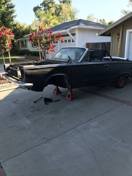

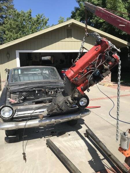

So I have a slant six with a Clifford intake and a split header exhaust got these parts from a 64 dart that had an automatic. The 64 also had a nice stainless steel exhaust set up that will now certainly interfere with the clutch linkage. So my question is is there a hydraulic set up that you can use on a Mopar bellhousing or aftermarket bell housing

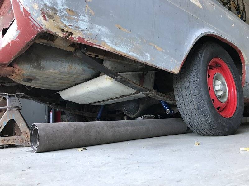

Cool dodged that bullet. I spent the last month harvesting all the parts off of the 64 dart, power steering, power breaks, 8 3/4 rear end that has already been swapper and a nice clean gas tank.
