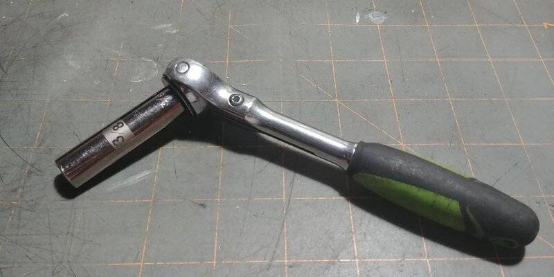

Only special tool I needed is pictured, 3/8" socket 12 pt swivel head HF ratchet
