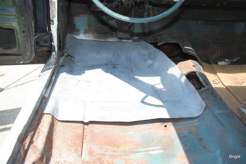

This photo is after I did some trimming for my area.
