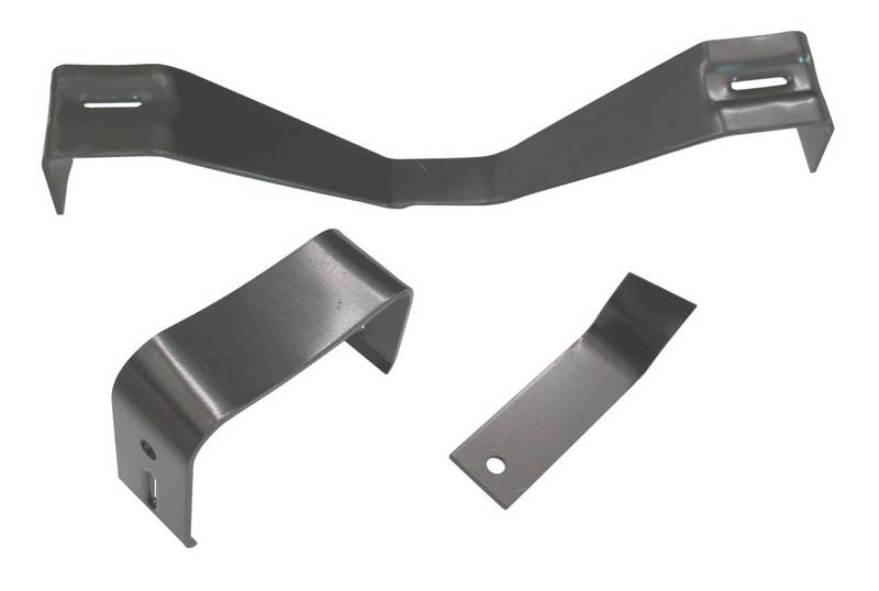

Brackets look like this
IF the same as other A bodies. Not 100 percent sure on Valiant.
