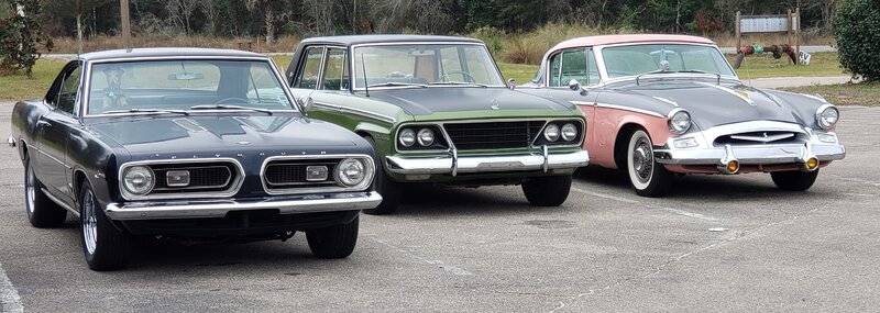

Here's mine.

It definitely looks cleaner without them. Years ago I had a guy offer me a pair of bumpers with bumper guards in good condition for a good price, even though my car didn’t have them. I should have bought them just because, but I never really liked where they were mounted. Since my car isn’t factory original, If I mounted them myself I’d put the bumper guard inside the parking lights for a cleaner look
My 67 coupe originally had bumper guards. I didn't care for them, and they knocked my knees more than once while navigating around the car in the garage. Now have AMD bumpers without guards. Have no desire to ever add the guards.
