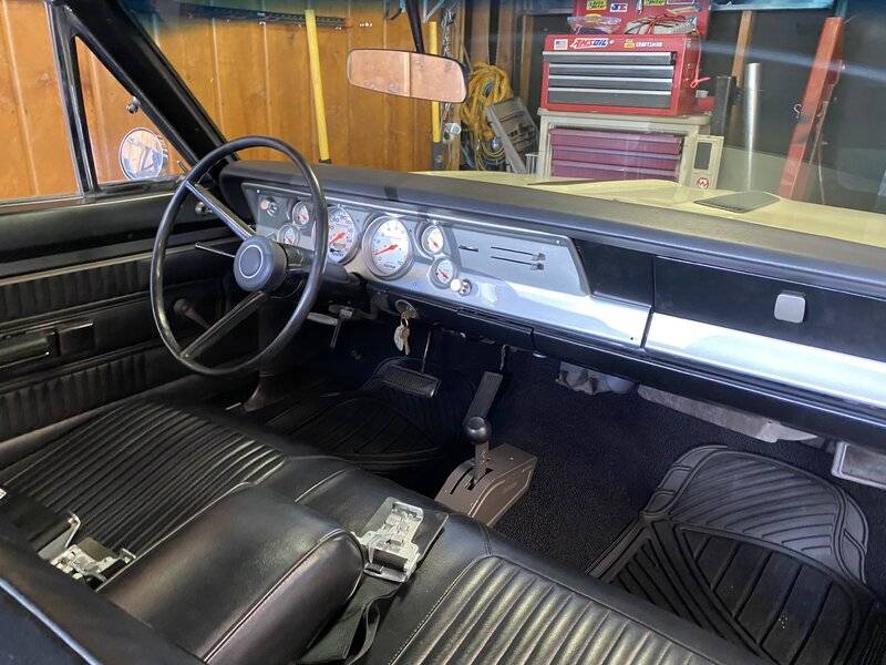

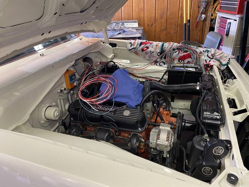

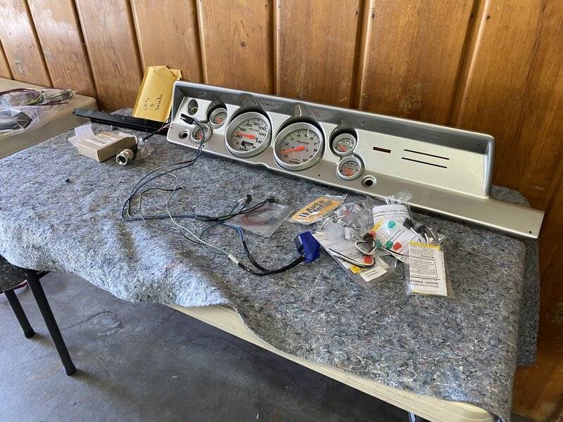

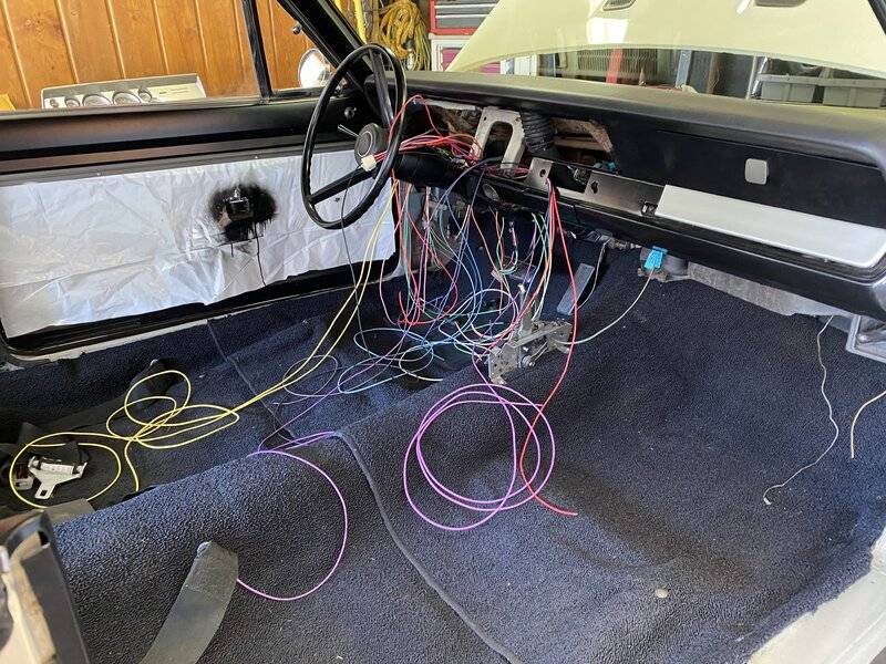

Ended up with EZ 21 circuit harness, Ron Francis dash switches and classic dash with autometer guages.
Mounted the new fuse box in the stock location, made a block plate for the firewall. Everything works great for the first time (Minus the Chinese fuel level sending unit) and Would recommend this kit.
