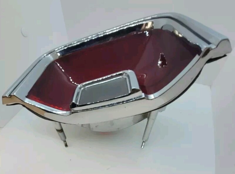

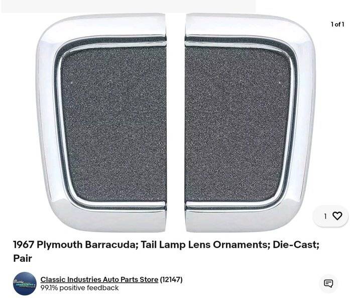

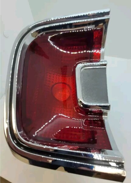

These pics are from an NOS taillamp that's currently being auctioned on eBay and the repro trim pieces being sold at Classic Industries. I'd say the color you chose is a darn close match!
