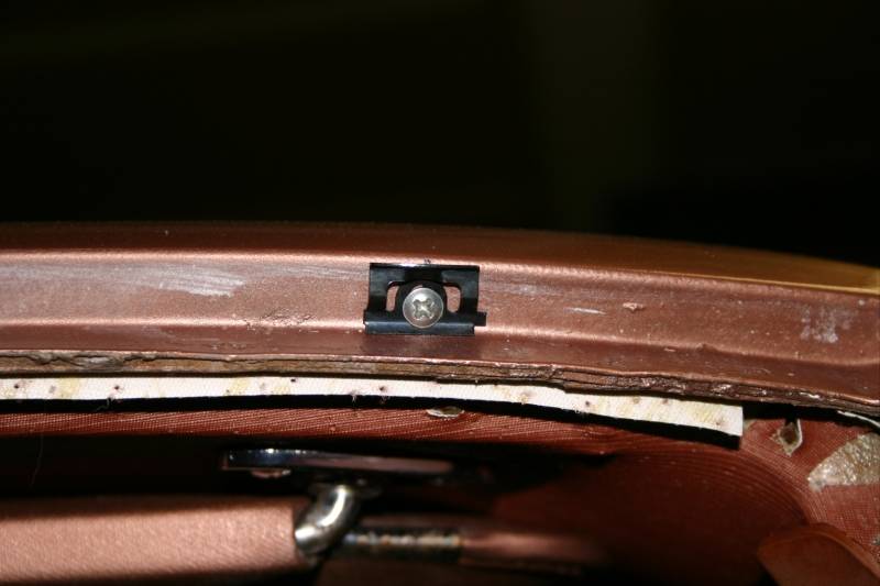

You can use the 68/69 weatherstrip/seal on a 67 with the 67 glass.
You will need to install the clips to install the 68/69 trim.
You must use the 68/69 trim with the 68/69 seal.
These are the clips needed to install the 68/69 trim
Alan
Al, thanks, that was awesome. I didn’t know the clips are screwed into the metal.
Tomorrow, I’ll be going through the box of trim to see what is what in there and about this all.
