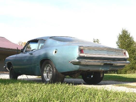

After digging into the Cuda getting it ready to sandblast the under carriage , I found under the small bubbles on both 1/4s behind the tires a few small rust spots .
And the trunk extension on the passenger side need replaced from an old repair from previous owner . Just the trunk floor part , not the metal that drops down to the 1/4
Anywhere to get these ? I thought someone modified some trunk extension from another model to fit .
Thanks guys...........
