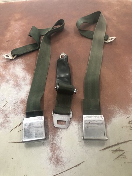

Putting the interior back in my 68 gt. Are the front seatbelts correct? Are the female portion angled correctly or should they be angled more horizontal . Also I have 2 longer females I assume are the rear seats and only one retractable . Did they have provisions for 3 rear passengers In 68? All belts are labeled 1967. Thanks. Mike

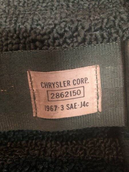

The labels should be q3 or q4 of 67 or q1 or q2 of 68
This tag is for a 67 model year
1967 2 (the 2 is quarter 2 ie (apr may jun give or take)
This male end is 67 model year
The male end had square notches
68 iirc has 2 rectangular holes where the 69 has one rectangular hole ( but I can not find a photo to prove that)
This is 69
Also typically the retractable should be to the outside of the seats.
Loosen anchor bolts.
Sit in and just seat to driving position.
Put seat belt on.
Tighten anchor bolts in that position.
Be comfortable.
Iirc the seatbelt should move freely on the post bolts
Thanks for the replies. I see I have the front ones reversed. I will move the retractable to the outside. Also took some pics of the labels
