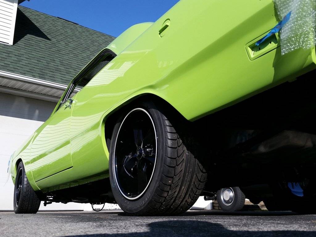

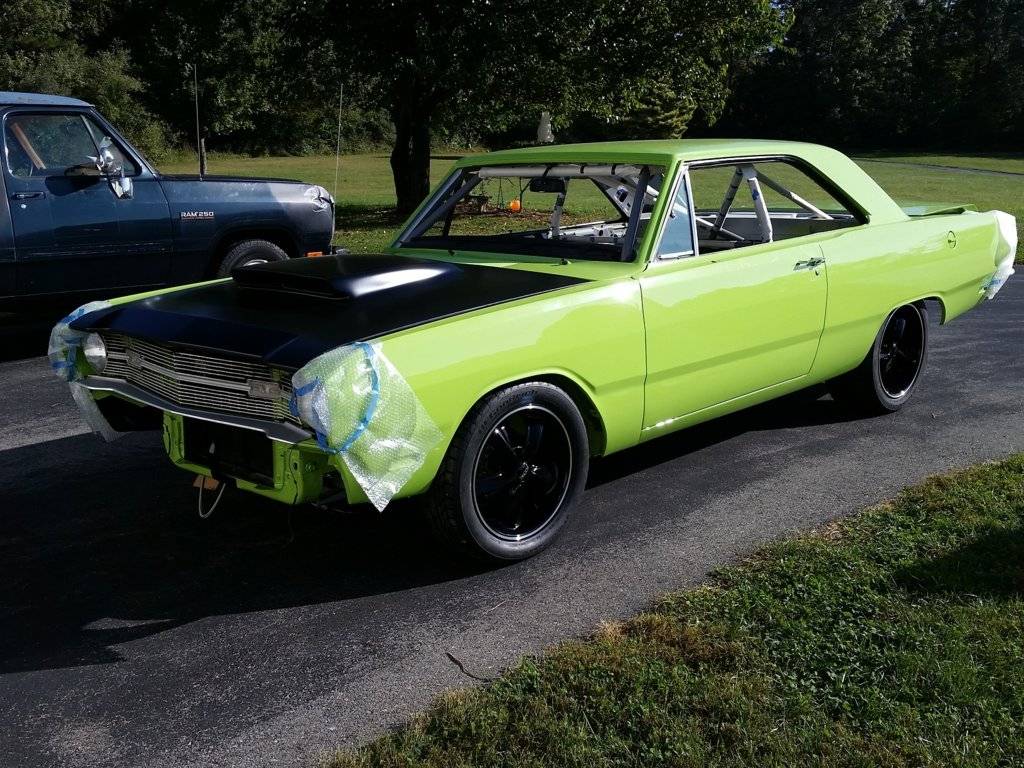

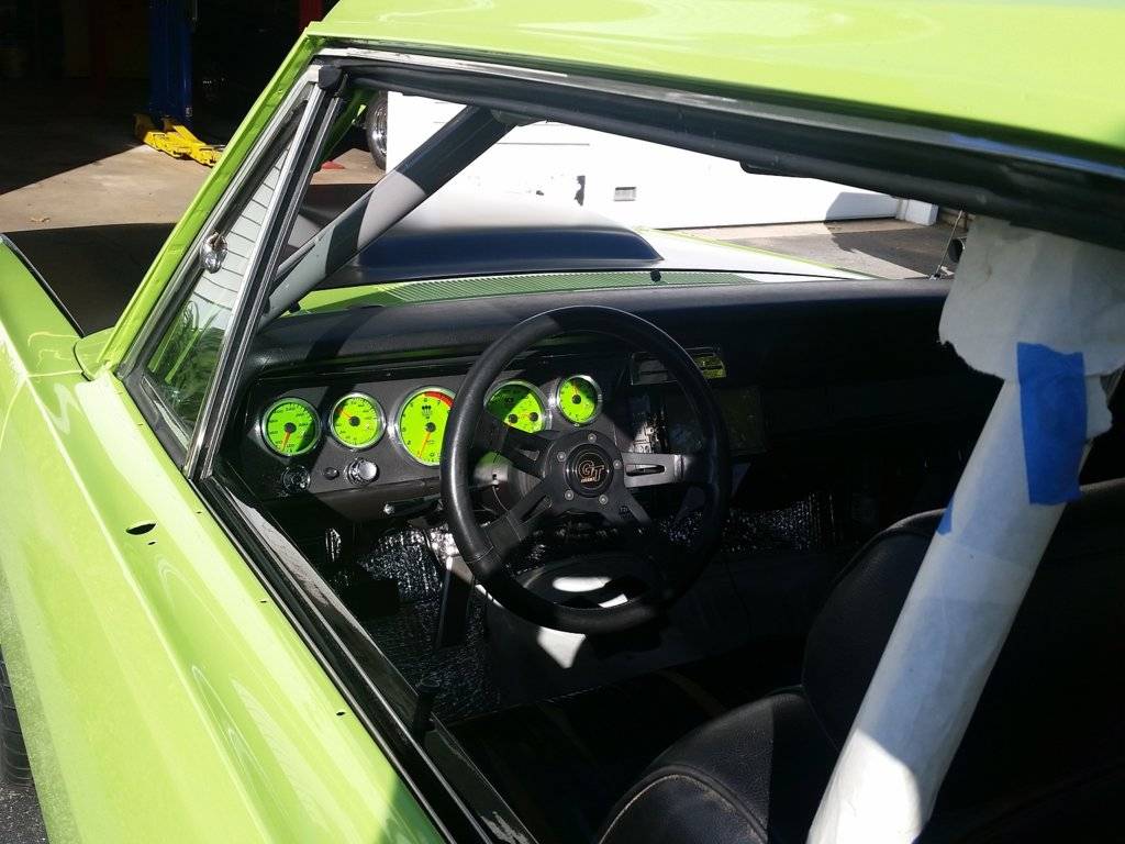

Here is a few pics of the Dart to date...
Fabman...if you look in that picture the black trim around the rear window is what you need. It was 2 pieces that covered the seal of the window. For the front windshield the window seal is all that was there. No trim for the front.
